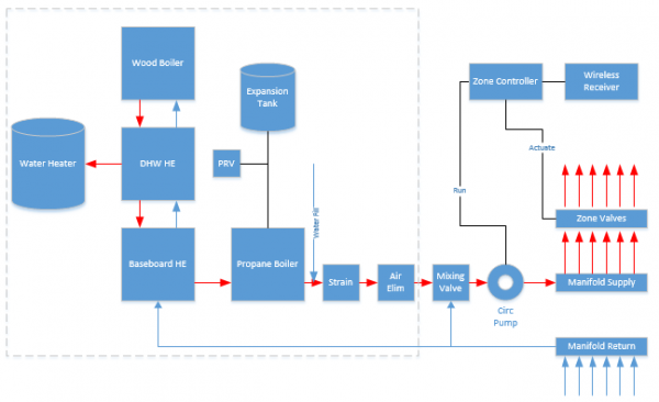

    This is kinda what I'm thinking. Not sure if this is correct or not. Right now everything inside the dashed line already exists.

    Not sure why it wouldn't work the way you have drawn it out

    I think it will work...but this is my first rodeo when it comes to this type of stuff....so I may not being taking several things into account that I don't even know about.

    Does my drawing look reasonable?

    It does to me.
    We have some others here that have more knowledge of hydronics.

    I see 'baseboard HE' - but where is the baseboard? Might have missed it.
    EDIT: Or maybe it comes off the LP boiler & just isn't shown?

    Baseboards come off the manifold. I want to keep the LP boiler hot so it doesn't cycle when it doesn't need to.

    Ah, ok. For some reason I was thinking the manifolds were for in-floor.
    I'm not seeing anything much wrong with that diagram. Think it has the basics covered.

    That looks pretty good to me. What kind of air eliminator aft you running now, or do you plan on using?

    I'm not sure on either account. I won't be reusing what I have now....and haven't picked out a replacement yet....just know that I need one.
