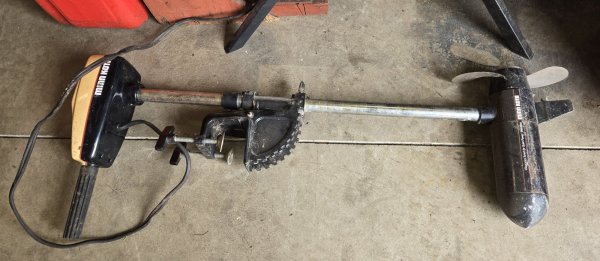

    Is a 28lb thrust minkota trolling motor enough to get around this to retrieve rc boats or fish? I highly doubt I'll take it anywhere else. Its the 12ft aluminum boat it would go on. The lake is about 75% complete in this vid.

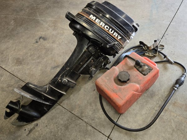

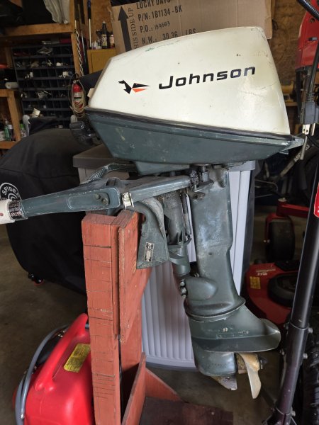

    The minkota and mercury came in the boat deal. The Johnson 6 horse was given to me. My original plan was to get them both running in tip top shape and keep the one I prefer. Now I'm considering selling both after getting them tuned up.

    I would say yes
    I would say yes but dependent on how much wind you might have.

    I have a 9.9 Johnson just like your 6.
    Sweet running little things.

    28 is plenty for that boat, unless you get a lot of wind.
    I have a old 25lb and it's able to move my 12' pretty quick.

    Im keeping the 7.5 hp mercury and selling the 6 hp Johnson. I cleaned the Mercs carb, just dark brown goo in it. No ethanol signs. Nothing was plugged. Fires up and runs great for short periods. One, I can't run it long because the water pump impeller is trashed and two, I don't think the diaphragm fuel pump is pumping. It runs beautifully then starves. Pump the bulb and it fires right back up. Imma head to the closet mercury dealer to get some parts.

    The Johnson won't idle no matter where I adjust the low speed mix setting. The nephew was in it so I'll probably have to go behind him and fix his mistakes. That's kinda normal with him.

    Franks mang. First time working on a boat motor. Think 10lbs of doodoo in a 5 lb sack. The Johnson 6 hp has much more room under the hood. I'll keep it over the mercury if I can get running as well as the mercury does.
