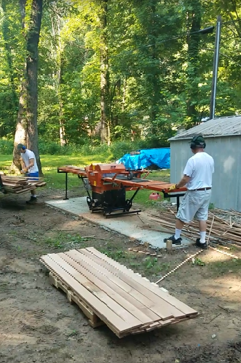

    I have a woodmizer edger, it was under your budget and works well (it was a twin blade). We have used it for both edging off the mill and also for cutting straight boards out of dried lumber that ended up crooked. Its a two man machine to keep it going, one on the infeed, one on the outfeed. Get extension tables as well if you are doing 8ft lumber. I cant find a picture of it right now but heres some 1x and 2xs i made with it poplar3.jpg

  8. Spencer
    Spencer
    Jan 27, 2016
    825
    5,053
    Indiana

    Hey thanks for the info that is one problem I usually work by myself [Just the three of us Me , Myself and I] and all the pictures of the wood mizer edger showed 2 people is the feed capable of pushing the board all the way through? if I would put a roller table on the output side would I be able to use by myself or does it require somewone on the output side Thanks JB:yes:

    Yeah you could work it by yourself, but you are not going to get the production out of the machine that it is capable of. Of course you would have to walk from one side of the machine to the other to offbear the boards after loading. Might be easier to just edge on the mill?

    Yep you could set it up that way, but you have to clear all the waste on the out side to keep it running. The waste on the engine side of the edger will essentially build up and not allow the boards to come out straight (there is little room between the frame and the non adjustable blade, only one blade moves on my edger) . If you dont need very straight boards, not a issue. the conveyer doesnt like the waste on it either when you are running wide boards. Hope this helps.
