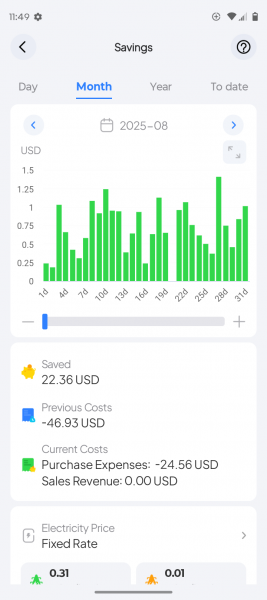

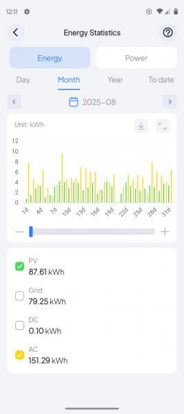

    Lost power twice after thunder storms. Pretty neat having most of the used things backed up and not needing the gas genny. The last outage was pretty close to dragging the gas unit out. I was down to 20% on the batteries and figured in about an hour I would need to get the gas gen connected. Priceless IMHO. We are pretty much sold on this and will be adding more battery storage and possible a larger battery gen too. Seems likely go with a 240V unit if the budget allows.

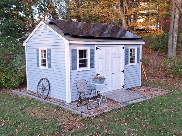

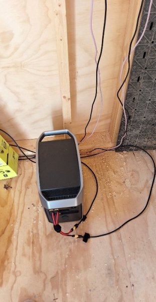

    So, I did a thing yesterday. More correctly, I had a thing done. Spring of 2024 I had bought 6 x 320w solar panels figuring I would put a garage or car port up and have at least 4 of them installed. Well, the carport hasn't happened. I'm tired of moving panels around in my garage and my shed roof faces south and I was looking all summer for someone who would install a small job (that was qualified and had insurance). I finally found someone :)

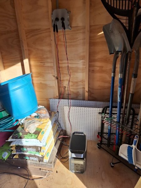

    I did have a unique install as I wanted each panel to run its own connection. That way I can hook up 2 or more stations at once, or use the max power coming in for each station connector (most of my stations have 2 x 500w PV ports so if a panel is pulling in 300w - I can take advantage of it all). I also have Bluetti stations, along with my Eco Flow stations. The Bluetti's have a unique plug into the station, so I needed the connections to be easily changed out. If by chance, I want to roll one of my big stations out there, I can run extensions for a 2S2P set up (or a 3S and leave the forth panel for another station).
    Connection on the east side with power station. I do need to get some stands to make it neater and add storage underneath.
    Close up for connection on west side (yes, the panel is lower on this side than the east side - for my own reasons).

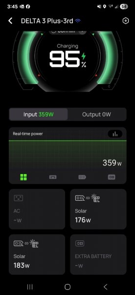

    Stats of input at 3:45 pm when the sun is already to the far west so sun angle isn't great, but the panels are pulling in a good amount. Regardless, still pulling in more than the 220w folding panels at this time of day.

    Finished on the outside

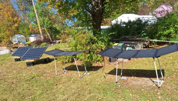

    I've already taken in the folding panels (the 2 on the right). Those are not meant to stay outside 24/7, but that is what I did with them since spring of 2024 (except winter). I couldn't take those down fast enough. The two panels on the left, are the same as the ones I put on the shed and I will leave them out there for now.

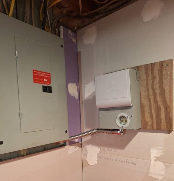

    Had a guy over last night to do an estimate for installing a manual transfer switch for using my battery stations in case of power outage. I have two EF Delta Pros, and four 2,048wh power stations that could be hooked up to the transfer station instead of moving them all over the place. Only need the two pellet stoves and the fridge on it. Has 6 circuits so I added a couple more for lights (basement, bath and living room).
    I'm supplying the transfer switch and all cables, so it is basically his time and expertise that I'm paying for. Accepted the quote this morning so now waiting for him to set a date.

    Transfer switch installed and tested wtih a Delta Pro yesterday :yes: It has 6 switches, which are about 3 switches more than I need (but don't have to use, so that is okay). Put both pellet stoves and the fridge on the MTS.
    • The outlet that the P43 is run from also happens to be on the same circuit as the stair light, so that is excellent for safety reasons.
    • The P61a circuit also holds the combi-boiler and nothing else (that outlet was intentionally installed for the stove on its own circuit).
    • Not sure what is attached to the fridge circuit - during winter I can put everything in the garage or shed anyway, so it is not a critical circuit in my mind.
    The other 3 circuits are for non-critical but nice-to-have lights - 1 downstairs and 2 upstairs. I have no idea what additional things are attached to those since I don't care and those are unlikely to be used anyway. I have sevearl battery operated LED lights that I would use instead of hooking them up to battery stations.
