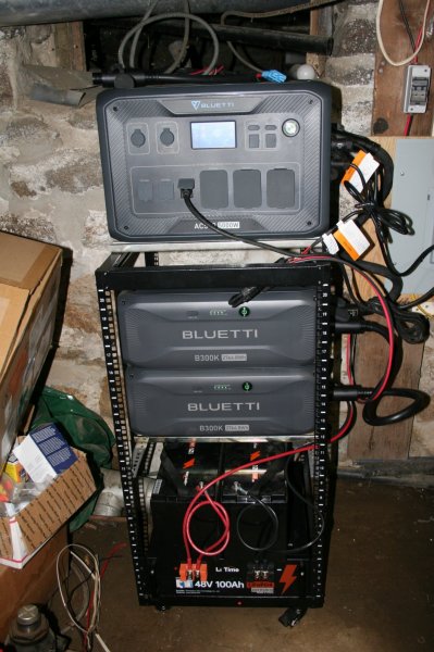

    New setup pic! Rearranged it to be less top heavy!! Nearly tipped it over trying to move it. More weight on the bottom helped much! Going to run it down from 70% to 10% to see how much extra umph was gained!

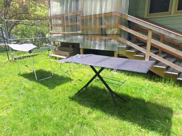

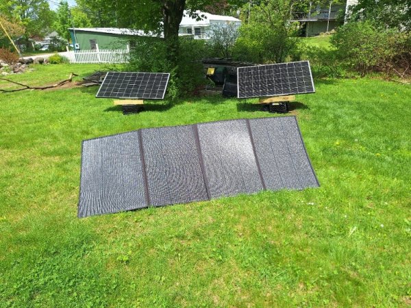

    Huh, that seems weird on how the EB's behave, but I really don't have any experience with that. I usually prefer extra stations themselves instead of EB. But, I use mine differently than you do, so it makes sense for my circumstances (at least to me). I do have two EB's, that go on my River 3 stations. One of those Rivers (plus EB600) is currently running my computer/router/wifi (or used for backup if I have to plug into main power). I've been using solar as much as I can to run this set up by attaching a D3+ station to the River as its energy source.
    Twice in the last couple of weeks, we've had so much clouds and rain that I pulled one of the Bluetti AC180's out for running the River. It makes me really remember how constrained the solar input is when I have to try to charge the AC180 (and how frustrating the app is). However, it also reminded me how good their PV350 solar panel is
    In front is the Bluetti 350w panel and the AC180 is nestled behind it to protect from the sun and rain (when it wasn't one, it was the other). In the background are two 320w panels each hooked up to an input for the D2m (my kitchen appliance power source). I go out and adjust the angle to the sun every hour or so.
    Two 220w bifacial panels charging a D3+ that is on the porch. Angle is not ideal, but I am constantly moving those around because of shade issues. The one on the far left moves the most as it starts out the day way over to the right (out of the picture) in the walkway between the stairs and the fence. It is easy to fold up and carry like that.

    The lower I run the power station, The more watt hours are gained from the EB's. From 1% to zero seemed to be where I gained the most. The Bluetti EB double the capacity I was getting from 70% to 10%. The the DIY EB's seemed to kick in. But only about a 1/3 face value. was going to do another charge and drain today, But mother nature said nope!
    The AC500 doesn't have time remaining or time to recharge like the AC200L. But the last drain down on the AC200L with 1 DIY EB the time to recharge with both the internal and EB connected was double what the internal battery would say. I do think I need to drain to zero before the DIY EB's capacity is applied to the system firmware. The 2 tests I did with the AC200L gained more each time on run down to cutoff. I'm trying the same on the AC500 after the next recharge. Hoping the case is true and I get a bit more capacity.
    Worse case is the DIY EB's stay in the system and then get connected to the PV on outages to extend the runtime. A good reserve in case of need I guess. At least they charge to full capacity when connected to the battery ports. No need for an auxiliary charger.
