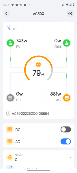

    Thursday I went up on the roof and put the 2 panels from parallel to series to gain some more umph from them. Couldn't really test them over the weekend due to icky weather. But I've gained a good bit of solar since the swap. I think I only saw about 600 watts max before. Still only around noon, But already almost 800 watts. Max sun comes around 2 ish.

    Remind me what size panels you have please. Roof mounted panels are hard to tell on what they will produce since they are fixed.
    600w is a really good haul from my two rigid panels in the yard since they are 320w each and that would be ~94%. I've seen higher, and even over occasionally on cold days, when I've managed to angle the panels just right to the sun angle is. Of course don't hit that for very long, but still nice to see.
