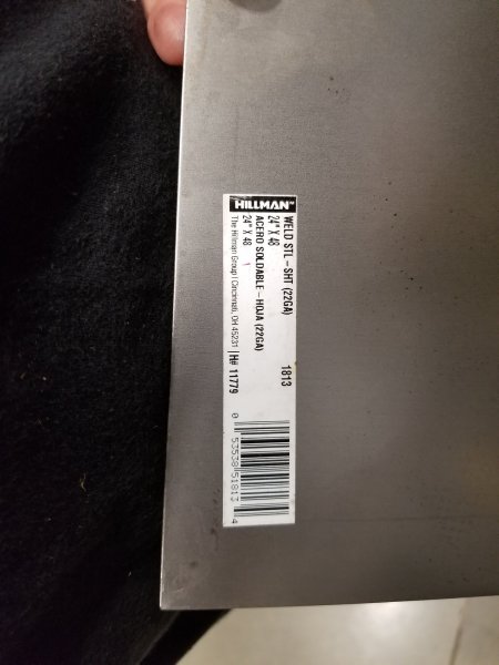

    When I install my insert this late summer/early fall I intend on putting up a block off plate. Was at my local box store this weekend (lowes) and found this for approx $30.
    I did not purchase just yet because my question is would this be ok? Or should I try and find a galvanized piece of sheet metal or would this do just fine? Also wanted to ask would aluminum be ok to use? Lowes has that as well! I have a local steel and metal shop too that I can probably get anything I need for this project but just wanted to ask. Thanks much in advance fellas!! 20180708_080810.jpg

    That would work fine...will rust though...I'd just get a piece of galvanized...I think they stock sheets of it for making duct work and the like...might even be a lil cheaper...and aluminum would be fine too.
    You can go a lil lighter than 22 ga. too...what ever they stock should be OK...22 ga. would work...just harder to work with...you are just blocking off air movement.

    Thanks so much Brenn! I think I saw 24 or 26ga aluminum I may just go what route!

    I would stick with the plain mild steel. It will last years.
    Galvanized can off gas zinc at certain temps and cause serious health effects. Your temps from the stove and liner may never get to that temperature point, but you will be heating a galv sheet every day the stove is running in your living space. Just my .02.

    Hmm, yeah, didn't think about that...I was thinking galv. off gassed at something like 800*...but I see they say not to use it over 392*...I don't get why its commonly used for vent pipe on oil furnaces...400* would not be that abnormal...

    I've seen it many times on boilers, not sure why. Corrosion resistance to nat gas is my guess.

    I'd just use this plain steel. Cut and or shape it to fit. Paint it with high temp stove paint for good measure. Then stuff the area above it with roxul.

    Thanks fella's prob just gonna grab some 24-26ga steel to use. I was intimidated by the whole block off plate but once I did the template and really got up in there I don't think it will be so bad.
