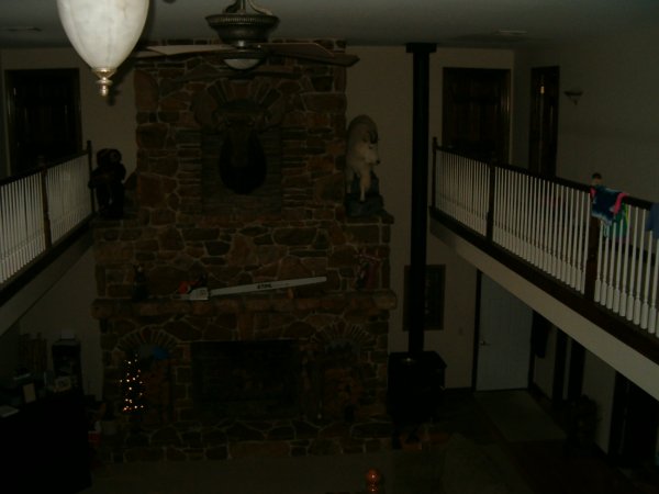

    I did find a picture (not a great one) I took last year, the saw is an MS880 w/a 59" b/c, overall measures about 7' long, the stone fireplace is 14' wide... HPIM0459.JPG

    showrguy no you aren't that way at all! and yup you need to post some more pics:yes: I just tend to be careful with those BK owners you fit right in! great saw! gorgeous stone work.. from what I can see!

    Thanks Canadian bored VT,
    I'll have to get some better pictures, the moose was 55" wide but his horns blend right in with the stone because of the poor lighting..

    Here, I touched it up a little for you, can't do miracles with it that dark to start with, at least with my modest skill, but maybe this will help a bit. Awesome saw, man. I'm still just putzing around with a cheap 290 and 20" bar that's probably too big for it :saw:
