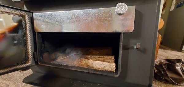

    Years ago, my wood stove had a metal flap the hung on a swivel over the doorway. When I had my Hearthstone Heritage you didn't dare try loading it from the front door if it was smoldering in any way. The smaller side door, no problem! So, on my BK, I made this flap out of sheet metal to reduce the door opening size when in place. I slide it in as I gently open the door, load up, and slide it out as I close the door. I never have any spillage. If I was taking these pictures without the sheet metal in place, I guarantee you, with the heavy air and light rain we have right now, smoke would be pouring out. For me, this has been a game changer. I can load anytime, without giving smoke spillage a second thought. Just buy a small piece of sheet metal from the hardware, a small bend, and done. Hardware may even have a piece of scrap, and probably bend it for you too if you don't have the tools. I have a video, but not sure if this link will work for you. I do use a small magnet (wrapped in tin foil for easy removal) to guarantee it doesn't fall off if bumped.
