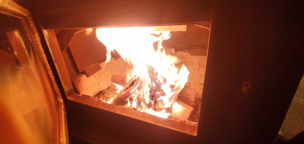

  14. Pyromaniac
    Pyromaniac
    Nov 2, 2023
    399
    1,254
    Central Michigan
    To give an idea of my start from coals this evening, here is a picture. Two small 3" splits with a handful of kindling on top. Notice, good draft, no lingering/spilling smoke.
    Nine minutes after starting, cat is in active range. Closed bypass and dialed back the stat a 1/4". This will give me a nice pile of coals in a couple hours to load my overnight onto.
