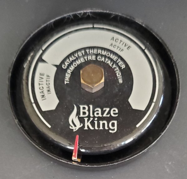

    When I brushed the entire chimney in October, I dismantled each section to the ceiling so I could get a good look at everything. The chimney was shocking "clean", just a thin dusty brown layer. Cleaned inside the top of the stove and thoroughly lubed the bypass moving mechanisms. What shocks me most since purchasing this BK with the cat is how clean the chimney stays, even after several months of use. My old stove years ago, I brushed the chimney every two weeks and it needed it every time! So, short answer to your question, it doesn't seem like I saw anything that would indicate some creosote leaking into the seams, especially how the deposit was just a light dusty coating. I'll definitely give it a second look though.

    Yes, you can overtemp your catalyst, and if that happens too often, you can damage it. It would appear to me that your catalyst probe is indicating a too-hot condition even though it doesn't explicitly say it. Though I defer to the BK experts.
    Would that lead to smoke smell in your house? It's hard to imagine how, but maybe? Perhaps though that's the one change in the last three years.... your catalyst has gone bad.

    When I got up this morning, after the stove had burned for 9 hours, the fire box was 1/4 full of very charred, partially unburned wood, glowing coals, with a thin steady flame flickering out of them. My catalyst temp gauge was pointing straight to the right (I guess I would call that about 3/4). So, the catalyst was still very engaged after 9 hours of burn. As I type this now, it's been 11 hours and the coals are down to just a really big, hot pile. The cat stat is pointing straight up, indicating it is very much into the "Active" range and doing its job. My understanding was, a catalyst that is bad or failing will not perform like this, but, spike high, then tank. Is this true, or not so much? I woke up to the house temp being 74° with an outside temp of 16°.
    Side note, no smoke smell. That's what's killing me, it's so random, but too frequent!

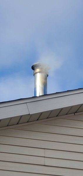

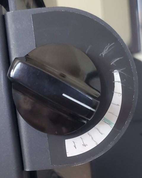

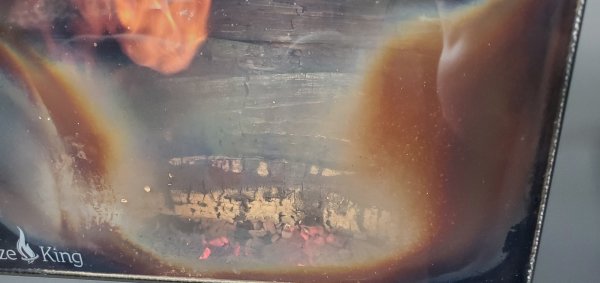

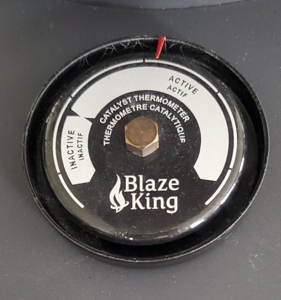

    A little more info. Reloaded firebox about an hour ago. Cat is HOT (see pic), fire is lazy(see pic), stat on low(see pic). I'm seeing noticable smoke coming from chimney(see pic).
  7. brenndatomu
    25,378
    165,410
    That looks like normal steam from a new load drying to me...if it was smoke it would linger/trail off for longer... IME if it's gone in the first 10' after coming out of the chimney, it's not smoke

    Just to add a random thought. I can induce the stink/beef jerky smell easily by turning the stove down to far, to early. Really a rare occurrence these days.
    I've had good success on reloads by initially making a rather large reduction in air that shows a slowing of the robust flame. Give that setting a bit (depends on how lazy I am!). I then reduce the setting position a couple more times in the next 10-15 minutes. I like to leave it alone at a setting that has barely snuffed the active flame. Normally.
    If its bucky cold out I will leave my final low setting where I have a very, very small amount of active flame. Eventually this flame will peter out and the stove will continue to run clean and very hot. No smell issues using these methods.
    Sounds like your cat is in fine working order. Almost guessing if you adjust your operation regimen a tad you may eliminate your issue. It's possible your low setting position may be a bit too low on occasion.
    My guess only. Best of luck fine tuning.

    Edit to this post 20 minutes later: I turned the stove stat up about a 1/16 of an inch an the "smoke/steam" exiting the chimney went away immediately. Cat is still glowing bright orange and no smell.

    It's really an interesting learning curve for any BK owner. When the actual stat "effective knob adjustment swing" of each install is ironed out the true fine tuning begins!
    Much of the available stat adjustment range means almost zero. The small portion of available adjustment range that actually completely controls stove performance is a tough thing to learn/understand/accept.
    All fun!
    As an example. My effective stat adjustment range is from wide open position back to the middle position. Really nothing less.
    Most of my fine tuning is in the last 1/4 of this usable range.

    PFM...Love it! I agree with you 100%. What I have discovered on my stat, is 1/16" movement on the stat is the difference between one single small flickering flame on low burn, or a full-blown fire in the box. The sweet spot is very small, but effective.
