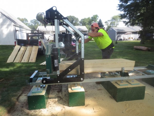

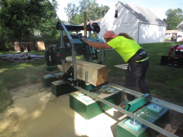

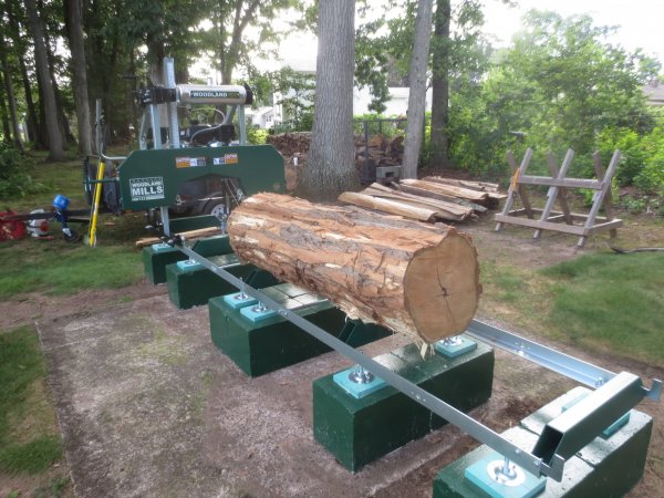

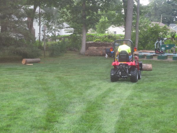

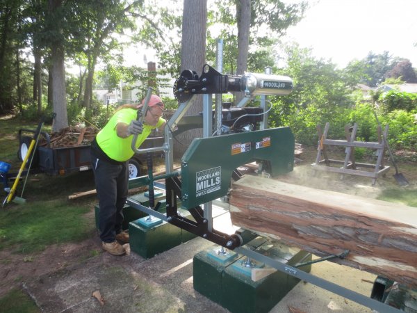

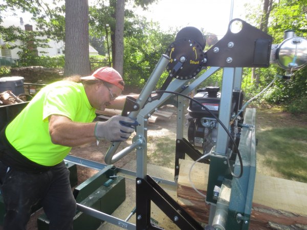

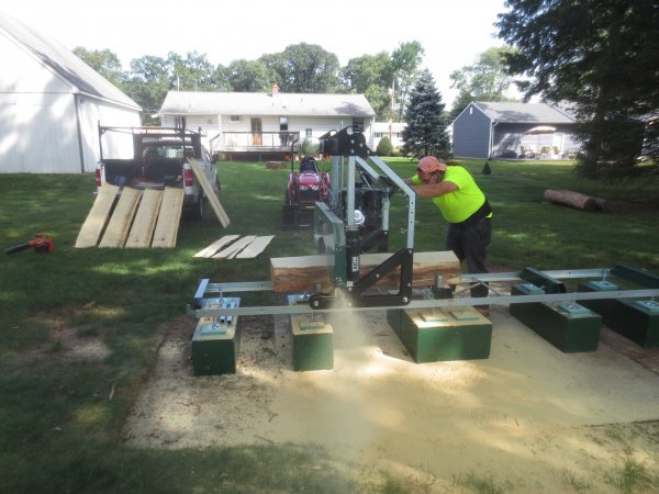

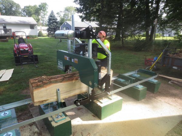

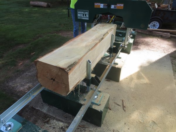

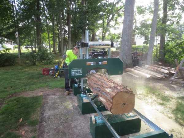

  13. buZZsaw BRAD
    27,604
    164,587

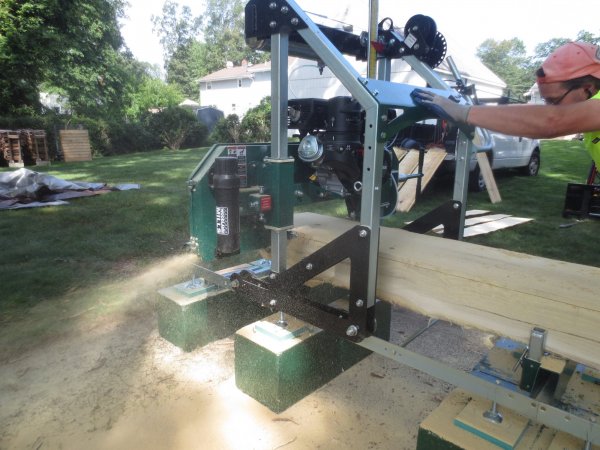

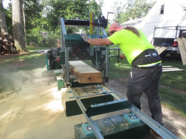

    Fixed my photo problem finally. Paper birch on treactor and left of pic. IMG_5447.JPG IMG_5448.JPG IMG_5449.JPG IMG_5451.JPG I was shocked when you let me run the mill. It was fun. Here's the pics he took. IMG_5452.JPG IMG_5453.JPG IMG_5454.JPG IMG_5455.JPG IMG_5456.JPG IMG_5456.JPG IMG_5457.JPG IMG_5458.JPG IMG_5459.JPG IMG_5460.JPG IMG_5461.JPG IMG_5462.JPG IMG_5463.JPG IMG_5464.JPG And to think all the nice locust ive turned into plain ol' firewood!

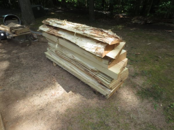

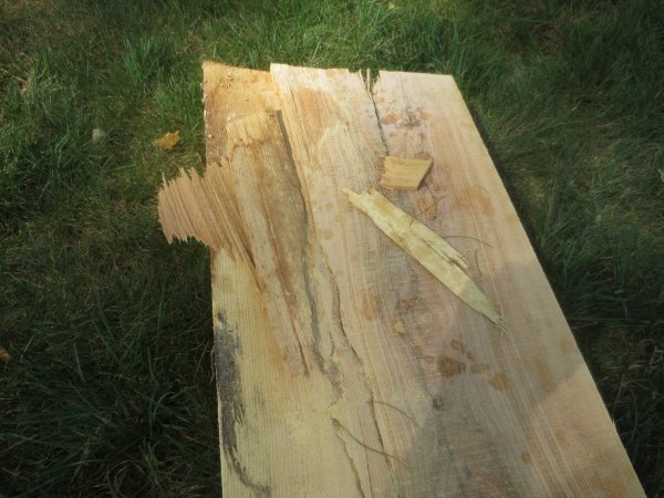

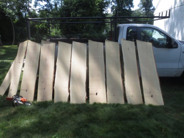

  14. buZZsaw BRAD
    27,604
    164,587

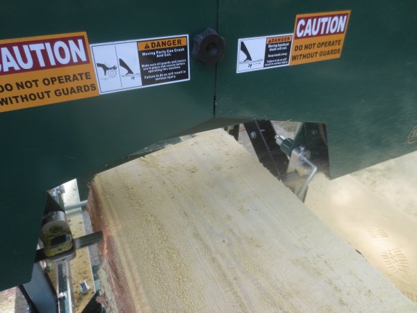

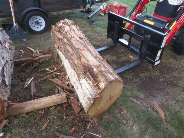

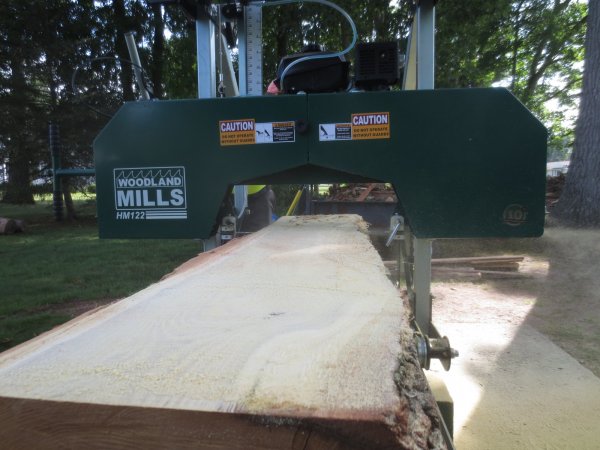

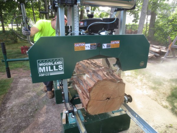

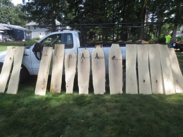

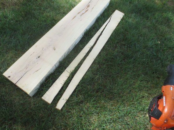

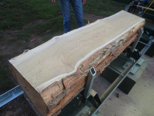

    A good day learning to mill checked logs. The biggest to fit in the mill too. Removed some bark prior to cutting. Got roughly two dozen decent boards. Couple 4x12 slabs the pith center. Some voids and lots of checks and rather than turn em into firewood i will make a couple of matched slab benches.

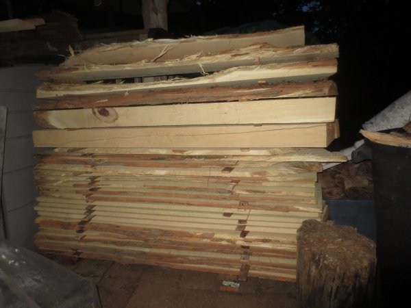

    One side of a 4x12 IMG_5465.JPG Made one pass for 1x6 but check was all the way though and it fell apart. IMG_5466.JPG Almost ran out of room on my pickup as we cut! Wood was quite damp from being green and the blade lubricant. Dry breezy day dried them off quick. IMG_5468.JPG IMG_5467.JPG Temporary stack when i got home. Have to make room to dry them and needed the truck right away. IMG_5469.JPG Ill post pic of stickered stack tomorrow.

    Made some room, got em stacked and stickered this evening. Both 4x12's and some slab wood for weight.
    Wood laths for stickers so 1/4-3/8" gaps. Outdoors in a mostly shaded area. Anyone know how soon this will be ready for use? Planning for unfinished outdoor furniture. Some flower boxes too. Should i top cover? I was going to use some thin plastic IMG_5477.JPG
