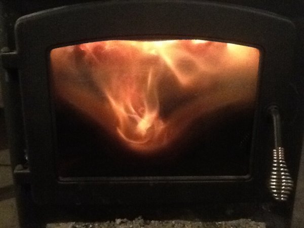

    Here is a pic of what happens to my glass almost every full load. Once the stove is up to temp 650+ and the air and key damper are set I get black glass that forms in this pattern. It burns off later in the burn and by the time I reload there is only a little bit left at the very edges. The black doesn't form on the glass until after I have restricted the air, on this burn the air is open about 1/4", stove is an Englander nc30. Anybody else see this? Pretty normal? On smaller loads, I can leave the air open a bit more and the black doesn't form, but on a full load I can't leave the air open as much and I see this regularly.

    Pretty normal. Primary air down=less airwash.

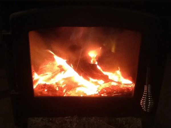

    I thought it was normal and nothing to really be concerned with. I'm pretty sure it's not from choking the stove down too much as the temp of the stove is high, it's just that I've seen lots of pics and videos of tube stoves with secondaries blazing and super clean glass. Here is a pic 8 hours later, never touched the air or the damper for the length of the burn, just got home and opened the air and key damper so I could rake the coals forward to burn them down, glass was clean when I got home.
