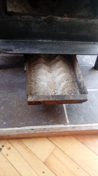

    Good info...wish you had some pictures of the ash pan. Don't think I've ever seen one on a Woodstock.

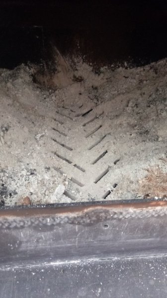

    Hoytman pics I can do.. I have an Ideal Steel. But they are similar.. 0726191336a.jpg 0726191336.jpg

    ok great...what's the chances of that thing spring an air leak? Is it pretty good design and build? Looks like it.

    I think its a good design, quality build in the great state of New Hampshire!! Chance of leak is minimal, got a gasket to inspect just like a door. If a slow leak starts any burner with common sense will notice. Stove temps would increase and burn times decrease. Alerting user to give it a good once over..

    Awesome design. I've used stoves with ash pans that were useless. I'd rather, and did, shovel the ash.
    Eventually, it'll need a new gasket. 6 years on all my factory gaskets so far....
