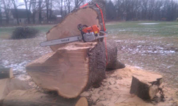

    First off, gnarly maple can be hard to split. It isn't elm or gum, but it can be bad. No shame in noodling if you have to or want to. Some of the rounds in your picture look like they have terrible cross grain and would be very challenging indeed to split.

    Thanks for the replies. I had a few things working against me yesterday - I had to get back to the wife and kids so only could stay about 30 minutes, it was raining/muddy, it had been raining for past few days so rounds were extra heavy, I couldn't back my truck right up to the rounds so no rolling, I only had one steel wedge, etc.
    I guess I was a little hesitant to break out the chainsaw and was a little overconfident that I could split with my maul and then lift into the truck. Will try noodling or noodle/wedge next time.

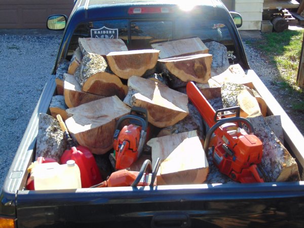

    I noodled a big chestnut oak last year.... 14 feet( ish) of trunk into 16 inch rounds and noodled them into 4 pieces each so I could get them in the truck.... it was a 30" plus tree and even the 1/4's of a round were all I cared to lift. I used a 6421 to do most of the noodl'n, but I let my ps421 eat one round..... more cc's is way gooder. as for the noodles, I think I could have filled the truck bed with them and still left a good bit, but I didn't take any with me.
    I also use a hydro splitter on most stuff.... I bought it, so I use it most of the time. I do have a fiskars, but I use it mainly on easy re-splits or tulip poplar if its not to big.
    No pride thing for me, If it needs to go into the truck and I can't lift it without concerns of injury ( i dislike injuries as much as the next guy ).... noodle it is.

    Speaking from an "economics" point of view, one of those rounds in the OP's picture weighs around 250-500 and I would estimate that a cord of hard maple in that state(not Pennsylvania lol, but partially seasoned) is probably 4000 lbs. That means that each 400 lb round is 1/10 of a cord approximately. I burn 3.5 cord a year so I would only need 35 of those rounds to heat my home for the whole yr. I like the economics of noodling :D.
    I like that, 3 of those rounds noodled up will make a nice big load in the bed of that truck and would probably heat my house for 2 weeks in the polar vortex part of the season. I'm guessing I could noodle 3 of them on one tank in the 461 with ease. not a bad haul for standing in the same place, not having to go into the woods to gather it, one sharpening of the chain(see below), and about 10-15 min of cutting, I like loads like that, great economics. Also lets not forget you get to run a saw, which to me if more fun than a splitter or a maul ;).
