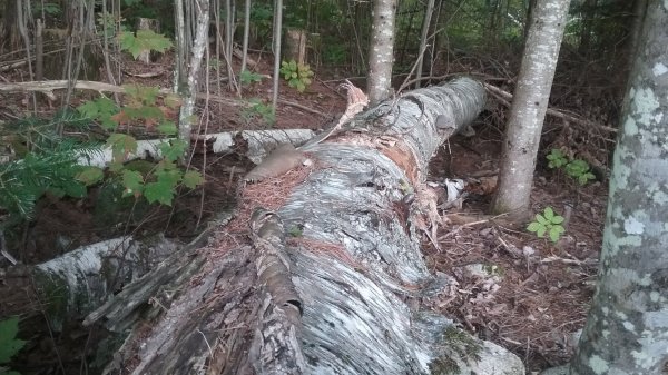

    I will go after this one soon. We'll see if there is rot. If not, there's a decent amount of wood in this large birch.

    Unfortunately that one looks like its not going to be worth your time. Birch on the ground doesn't have a chance to be salvaged for firewood.

    Your probably right, but I'll put the saw through it just to see. Mostly birch and pine around these parts......

    No insult intended, but you might have more fun if you bring a hoe.

    I'll bring that too! I need to fill a low spot on the new trail! :D

    That one sure doesn't look too promising! But it should make for good fill. Like Paul bunion said, bring a hoe along.
