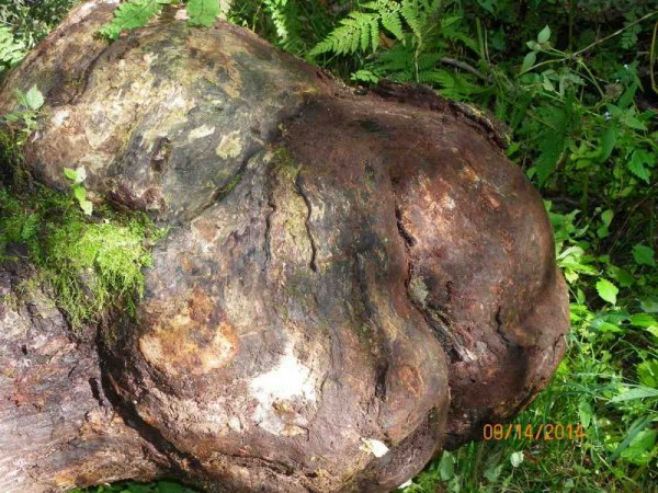

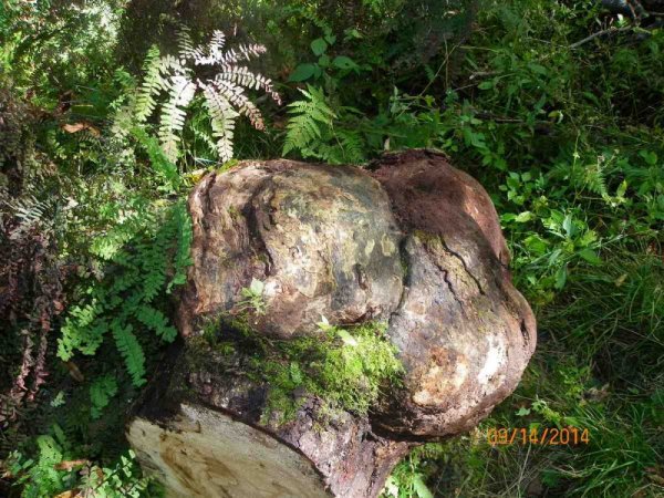

    This was down across the trail, all of the tree was rotten, what are the chances the burl is good.
    What is the best way to cut this off?

    chainsaw as close as you can to main stem.Sometimes you can tell whether its solid or a hollow shell to varying degrees by tapping on it with your axe or boot.....

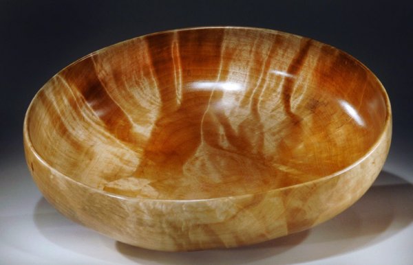

    Stuff like this...

    looks like an insect burl with the open holes/lines.
    If you decide to cut it use a chain that needs sharpening anyways (one with little life left) go for it.
    Cut above it first, see how a far the damage is before you go all in

    Or, if you know of someone that has a band saw with a higher cut capacity, you could end up with some nice slabs/breadboards.

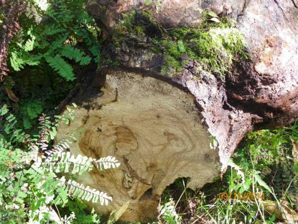

    This is what the end cut just down from the burl looks like, rotten.

    Depending on the damage, a carver can use power grinders to hollow it out and make a free form bowl.
    Small carvings can be made of salvaged pieces.
