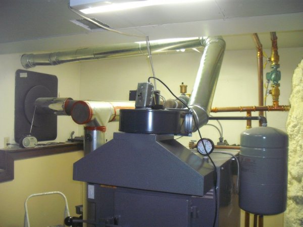

    I installed a fan on my Wood Gun gasification boiler that was made by same manufacturing company. I would not be without a hood/fan with the boiler in the house. Before I had it I had to wait until the fire was almost completely burned down in order to reload. Or place a fan in the window to suck the smoke out of the room when I had to reload with a hot fire going. Much better with the hood. I still try to time it so that I am reloading when the fire is almost gone. Just works well that way when you are loading dry Ash and Pine into the boiler.

    Not the greatest video but you get the idea...

    Mike, can you tell me please what the chimney diameter and the vent off the boiler?

    The boiler has a 6" flue. And I have it connected to a 6" class A chimney (exterior)
