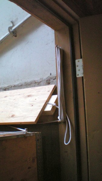

    Welp... I didn't destroy the bin with the first 2/3 load yet. Got it in before it started pouring here too... :yes: Here's proof...
    Rope worked great to hold the weight back while loading and to "lower" the heavier bin down the rails into the basement.
    Tossed em down easy this first time and watched the sides for bulgin'. Not too bad.
    2/3 full (2 JD buckets). The bin rolls OK with the weight. So far so good.
    Ahhhhhh... :fire:

    Yeah, they roll perty good now, but if they were full above the top... dunno. I think the bottom removable panel, at least, needs a stiffener to help keep it from getting pushed out as the heavier weight shoves down. They push out about 3/4" now. If I can keep from destroying the bins chuckin in the splits, I think they'll work perty good overall.
