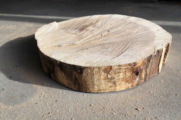

    So I had a pretty big ash log in my garage for 3-4 years. I’ve been waiting for it to dry with a plan to slice off a 5” cookie from which I’d make a coffee table
    I finally cut it today. Just wondering what I should use to sand it down...there’s a lot of rough surface from the chainsaw. I thought about a sanding disc for my angle grinder.
    Thoughts? Sorry if this is in the wrong subforum.

    I would start with my planer after sharpening the blades to get the high spots and then switch to belt sander with 50 grit. Keep checking for flat with a straightedge that reaches the full diameter. Mark high spots and keep working them down. After you get it flat with 50, go to finer grit.

    Ok that makes a lot of sense. I need to get a planer and a belt sander though...which isn't a bad thing.
    I can probably get another cookie from the log.

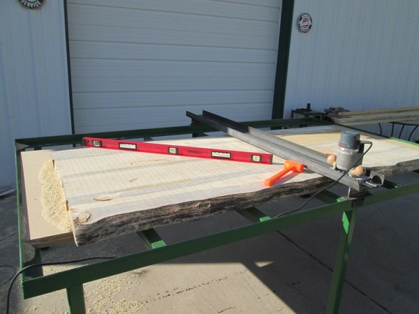

  9. Mag Craft
    Mag Craft
    Dec 15, 2014
    4,802
    27,714
    South East Wyoming
    Here is a pic of a table with a router sled used for leveling or making flat large pieces of wood.
