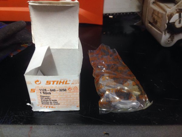

    HO oiler is around $90 retail. 32" is a good size to run on it.

    Pm me if you want an HO oiler for that saw.
    You need the HO for anything over 25" IMO. In good cutting conditions the 28" oils adequately but just barely.
    36" is doable on a 441, but you're prolly gonna want to do full skip chain and non E fuel.

    Mine pulls a 28" full comp real nice:smoke:...problem is the oiler..if u dont run canola and into some big wood it wont oil worth a hoot..idk what is is with stihl and their stingy oilers:rolleyes:..wait till you see where the teeny oiler screw is..first thing you thik is wth?:picard:...i think MasterMech did a oiler chaneout thread..i think it was $80..btw i think the 441 rocks 2!:dex:

    You can make your own HO if you want to do some grindingon the plunger.

    Whether it's a 25" or 36" won't matter as far as the saw goes. Doesn't matter if it's new or old as long as your under load and not bogging it really bad.
    The oiler is the limit. Stihl set that at 32". How they come up with the number? Is beyond me.
    MM has a good offer on the HP oiler.. And Mdavlee may have some insight on how to make your existing oiler work under these demanding conditions.

    Mike would know more about modding the existing oiler. I have the HO parts and a willing victim that I can snap a few photos of the process for those that would rather go that route.
    Then of course there is the new oiler kit which is rather spendy (at the typical dealer retail) IMO.

    I thought there wasnt an HO oiler for the 440/441 ?
  14. MasterMech
    9,648
    26,044
    Greenville County SC
    There is not for the 440, but the 441 uses the same oiler as the 460/461.
