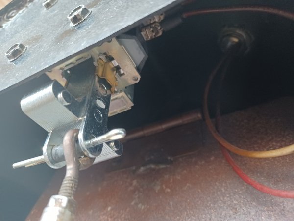

    Everything checks out as to door movement, voltage etc. 20211105_124152.jpg 20211105_124205.jpg

    You didn't happen to notice that the solenoid sounded different recently (louder) did you? Or the replacements sounded different than the original? If they aren't allowed to make a full stroke (full open) they will buzz louder...or, depending on the design, there is sometimes a mechanism built into the solenoid that takes part of the coil out of the loop once it opens fully...the watts that it pulls at open should be much less than when its first activated...that JE solenoid I linked to says its 17.9W...I would assume that would be in the hold/open position...probably 2-3 (edit, I looked it up...its 4.9A when pulling from the fully extended position!) times that when first activated/opening...would just see a quick spike on a meter I'd say.
    Did the other ones burn up so to speak? Or just quit working and still look fine?
    Wonder if its possible that the mechanism that switches it from "open" to "hold" is stuck, or bent, and only the holding part of the coil is being powered...so then not enough power to pull open?? (if its that type of solenoid)

    2 of the 4 were very loud when open, the one I just put on makes no buzzing noise at all. The one that lasted a couple hours was also quiet. The original solenoid was getting loud on occasion, but lasted 1 1/2 seasons that way. I'm not sure what would be causing failures. Door moves very easily, spring is not real tight, I've kept it lubed up & clean, voltage is steady, I'm not sure what would cause the failure? Open to ideas, this is getting old.

    If it starts to make noise again see if pushing/pulling on the linkage makes any difference in the noise...that and check the voltage when it happens...I maintain dozens of "solenoids" (3 PH motor starters) and when they suddenly get noisy that's generally not a good thing...something is going on there IMO...might have had one bad one in there, but it would be highly unusual to have a whole bunch of them like that...and the fact that you've had decreasing life span on them reeks of an existing problem that is still there...hope I'm wrong and it turns out to be a bad batch, but I doubt they'd admit it even if it was true.
    I know you guys are a little colder up there than here, but still not that cold out...is it possible that with the lighter heating load that the boiler is idle longer and the door could be getting temporarily "glued" shut with creosote until the solenoid overcomes it? With the pull stroke pulling 10X the amperage than the "hold" position does that would take one out pretty quickly...I think I've read of other people having issues with this on their (other brand?) boilers...can't remember if they were getting glue shut, or open, but I know it was a creosote problem either way...don't recall what the cure was...(load less wood, but more often?)
    Another thing you might want to do to establish a baseline is shoot the coil with your infrared thermometer (I'm sure you have one, or 5) after its been on for a while, see if you can figure out what "normal" operating temp is...

    That's a good idea! Yes the bad ones would quiet right down if I held up slightly or just wiggled the door. The newly installed unit is dead quiet & there's no way for this door to get glued shut. It's well away form any creosote buildup I can open it without any resistance with just a finger. I suppose I could put a lighter spring on it. I'm gonna check resistance between new & burned out parts.
