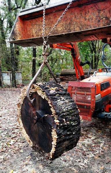

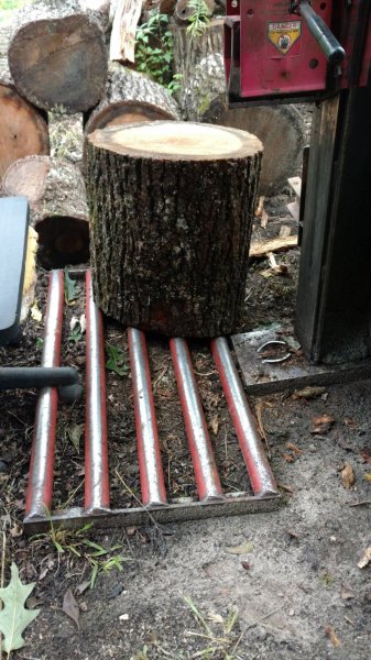

    First of all, what equipment do you have now? How much $$ do you want to spend on a splitter? We have split quite a few over 40", with a regular splitter in the vertical position. This is a platform we made for the bigger rounds. Roll them next to it, flip on the pipe and slide under wedge. IMG_20180720_132925695.jpg IMG_20180402_080253.jpg IMG_20180402_080118.jpg this is a pry/chop bar we made IMG_20181001_105758683.jpg Also use a 48" cant hook.

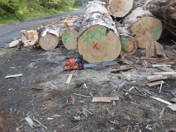

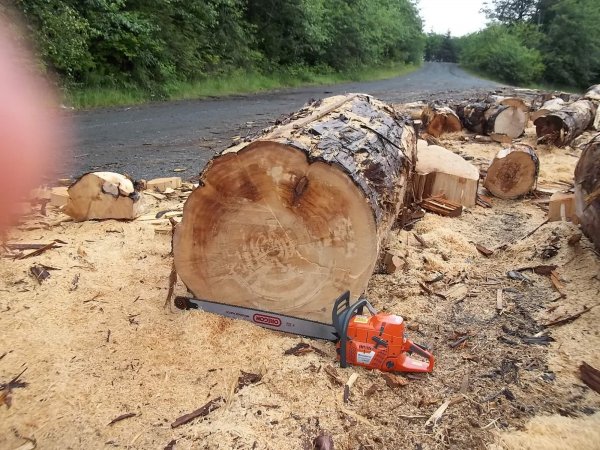

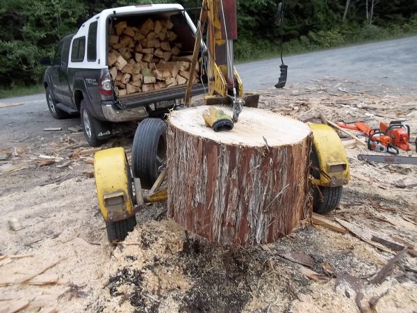

    The Beaver with the winch is a good machine for big rounds ,but to use the winch you have to stay hooked up to the pickup or the splitter just upends .
    The downside to the Beaver there was only a dozen of them made and in the 35 years that I owned this one have never seen another for sale . Of all the machines that are made today IMO the large Timber Wolf is the best for handling big wood .
