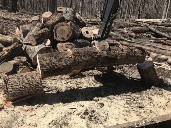

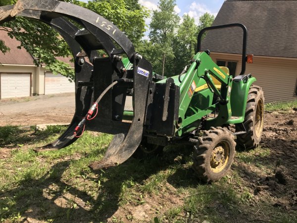

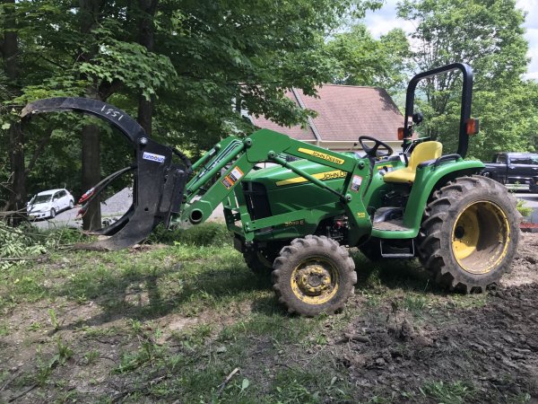

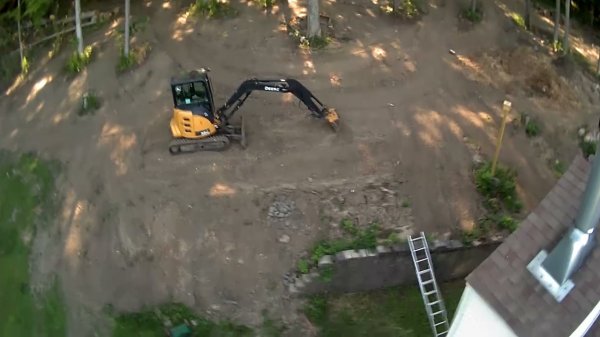

    C0867198-F466-42D9-88BB-D872F71DF245.jpeg I found this grapple on Craigslist two years ago. Had to weld on jd quick attach pieces. Upgraded below to a mini with a thumb. 3C249E9D-A252-4712-97AB-F268A32CCCC3.jpeg 8DA06561-6810-437B-91A7-5606469F5850.jpeg FFFD217E-F09C-44E9-9354-16818DBCE6C4.jpeg
