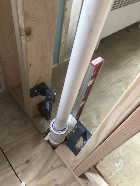

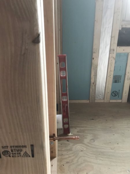

    First pic shows out of plumb. There is a PVC flange sleeve that will slide into that.
    second pic shows part of the carrier assembly. The cast iron ring and bracket the plumbers broke. Started the process of making a new one today. Busy day. Insulation guys arrived and I taught my mom some blacksmithing. Taught myself too :) Had to make a ring of steel as the first step in fixing the carrier.
    Took me months to find that old new stock carrier. Wasnt enthralled with the idea of trying to find a second. Nationwide internet shopping searches during covid is a real mess. That’s why I’m fixing it instead of just buying a replacement.
    These plumbers really dropped the ball this day. Broke the carrier. Had wrong hole saw so they just hacked out the sill plate with a sawzall. Out of plumb tee. And they tried to leave that day as finished with a huge water leak. I was so pizzed I had to leave the house and cool off.
    This is one of the reasons I normally do everything myself.
    Meant to snap some pics of the trunk line in the basement. Forgot. Not the easiest conglomeration of odd degreed elbows and angles to melt into a different position. Thankfully it’s not much movement required.

    How does it attach? Wax ring connection to the pvc and mounting studs to the wall? If the pvc was providing some kind of support, I could see how a little upward angle would cause it to bend down with the weight of the toilet. But I wouldn’t think you would want plumbing to support the toilet. Hang in there. Good that you are making sure things are getting done correctly. Fewer problems later.

    https://www.zurn.com/media-library/web_documents/pdfs/specsheets/63136-pdf
    not wax but a foam type ring. In days of old they would be Felt.
    Best I can tell this carrier is a replacement part for 1950- 1960’s residential wall hung toilets. Of course no one ever breaks a carrier so manufacturing and sales are limited.
    Mom wanted a wall hung. She also wanted an exterior tank not in the wall. Plumbing salesperson got her two 1960’s replacement toilets but no carrier. No return on special ordered toilets.
    Told me on the phone they don’t need a carrier, just bolt it to the studs LOL. That of course is utter nonsense. No wall hung toilet has ever just been bolted to studs. The carrier not only holds the toilet but must hold the pipe and gasket firmly to the toilet.
    So through many trials and tribulations I found this carrier.
    That was just the beginning of my headaches. Carrier is designed for 2x6 wall. But also designed for old black pipe straight tees which at the time did not have the small directional radius PVC has today. Hence new are larger and I’ll need to furr that wall out more.
    The fit is pretty specific. Not much room for error. Having the flange angled like that will make a real hit or miss installation.
    Bottom line is I no longer trust these plumbers to get it right the first time. It’s been hacked enough.
