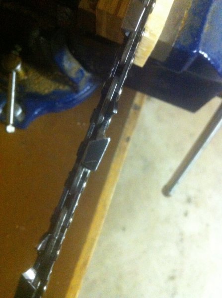

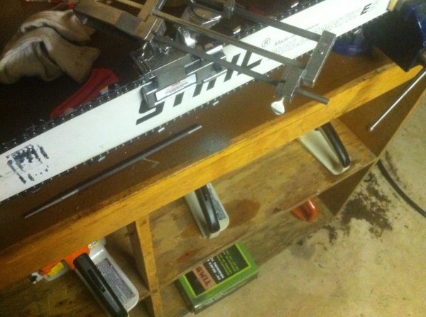

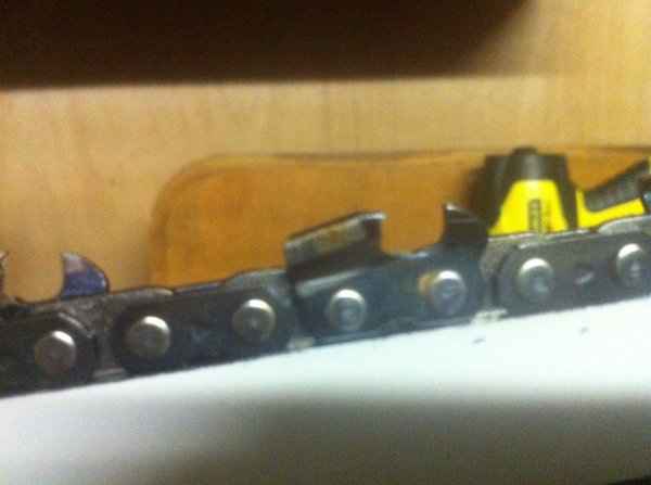

    You want a practice chain? :D
    Of course, its gotta be a 28" full comp chain that gets rocked out. :headbang:I've got a couple hours into this one on the granberg, and there's still a few cutter that need another 1/16" off.

    3/16" double cut carbide burr for those rocked out chains to get them close......... and then file.
    mike bayerl and mdavlee like this.

    Unfortunately I have plenty of "practice" chains out in the barn.
    HDRock and Shawn Curry like this.
