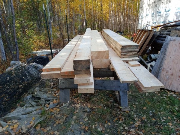

    This is the lumber I had on the ATV trailer.
    About 1/3rd of what I need for the Arctic Entry ( enclosed, insulated porch) . IMG_20210909_140013460.jpg

    I try to maximize what I can get out of the log depending on length. And of course diameter.
    When I'm working a tree up. My default bucks are 16'6" . But if there is a fairly significant grade break I will buck for the pieces of lumber that I need at that length.
    My target thickness is 1" or 7/8", for my friend I saw 2 bys at 1 5/8" thick x 5 5/8" for 2x6.
    For myself I mostly saw 1 3/4" thick for 2 by stock . For 2x4s I mill 1.75x 4" . 2x6 are 1.75x 5 5/8" . 2x8 are still 1.75 but I rough saw to 8" . X 10s I go 10"
    It seems to be that it's easier to get 2 real nice 1 5/8 x 5 5/8 out of alot of the logs I get . Than 2, 1.5x6
    I will slice 1 by boards off and not feel too bad about a bit of bark wane. I very much dislike framing with bark waney 2 by lumber. Pretty much Hate that.
    The lumber I sawed to frame the house I had a bit of bark wane in some of my lumber and it caused me grief. I have 1 dip in a butt joint of subfloor from a 2x8 I milled that had 50% wane in 1 part of the plank. I was going to scab a piece on the side of it . But when I joisted this floor I was kindof a 1 armed framer.
    So in short
    I get all the Good deminsional lumber out of a log I can , For what I'm going to be building with that lumber.
    I sawed 2, 4x10 beams for the entry . 1 is 4 5/8x 10. The other is 4 13/16 x 10.
    That is what it came out to be after I had adjusted the blade level .
