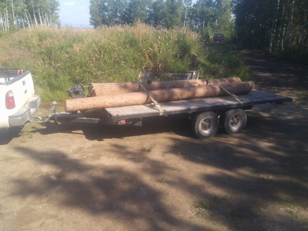

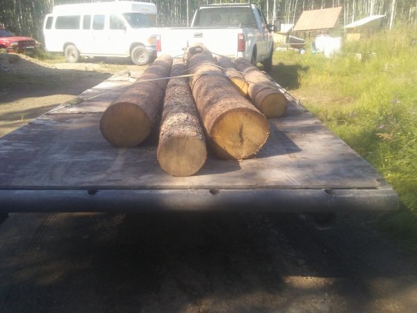

    Anyway here is a small 1st load of green white spruce that I will be making 6x6s and 2x6s from on my Mighty Mite Gen ll band mill.
    I've never hauled logs on this trailer, or been to his sale. This was all the logs he had on the landing so it was imo just right. 20210805_152143.jpg 20210805_152104.jpg

    Nice straight logs for the mill.

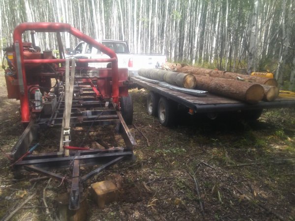

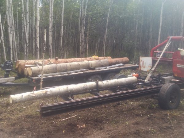

    Got a place cleared enough to get the mill in and the log trailer on 1 side and a trailer for lumber on the other side. Message_1628804088950.jpg Message_1628804002729.jpg

    That looks like it will be a pretty efficient setup. How far is the landing from the homestead? If it's anything like around here all the projects never get done before winter, and don't really even have winter anymore, just mud.:mad:

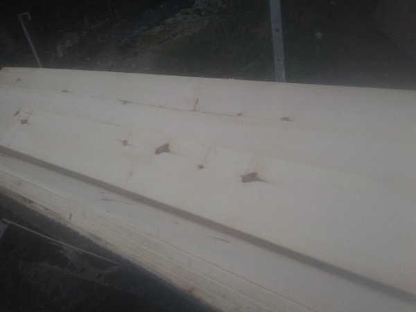

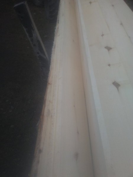

    20210826_175626.jpg That is a Great idea !
    I did finally get the mill so it's sawing Square. I was fighting trying to get it to cut a SQUARE cant instead of a trapazoid.
    Finally I read the mill instruction book. Did some measuring and sure enough the band blade was 1/4" out @ 18" width. I adjusted it and Now it cuts Square .
    So I squared up a cant That I had 4 side slabbed . Then sawed 7 , nice 1x9x11' aspen boards from it.
    I'm Really happy !

    Some nice boards. Having not seen used or used a mill myself until this year i cant say how cool it is to see a log sawn into boards. Ive always looked at them as firewood, but now its like "ill bet that'll make some nice lumber." Great pics CTF, keep em coming.
