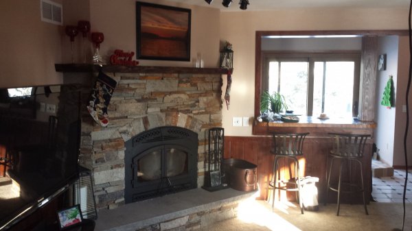

    My fireplace is short and wide, I like his better, I would have put in a small woodstove that comes out on the hearth if I could have.

    I'm thinking a minimal amount of modifications to the existing surround, and a new Woodstock free-standing stove. Yes, the stove would protrude a bit but the end result should be more than acceptable.

    It is clear to me now that I need an insert. And Scotty Overkill, that is a beautiful fireplace and in terms of the insert exactly what I am looking for myself!
    jeff_t, it is my intention to remove the brick facade that is there currently and rebuild the fireplace (to the dimension of my chosen insert). You are probably right that I would not find an insert that fits the existing cavity.

    It appears that I am a bit confused. As jeff_t pointed out, I may need a zero clearance fireplace and not an insert after all. To clarify, if I am already planning on redoing the masonry, therefore it makes more sense to install a fireplace (not an insert), correct?

    It would be an expensive project, and a pretty major undertaking. It would include demo of the existing fireplace and chimney.
    If it is possible for a mason to enlarge what you have, that might be more cost effective, but if including the purchase and installation of an insert and liner, there may not be much difference.
    If you want fire, a wood stove and chimney in another location would be the least expensive route.

    I agree with Jeff, too small of an opening for an insert(unless the picture was modified in some way to scrunch it up..other things in the picture look right though..door/window).
    No way I'd spend the money to have the fireplace opening made bigger to stuff an insert in it. I'd demo the existing fireplace opening/close up the opening and place a free standing stove there. Line the existing chimney and connect in higher up by poking a hole through the wall. If another location would be better for a free standing stove I'd abandon that location all together.
    Now if the "look" of the fireplace with a mantel is important do as you need to get the look you're wanting.
    I guess the big question is are you looking to gain a little self reliance by heating with wood or looking for a kick a@@ looking fireplace. :)

    Zero clearance fireplace here.
    Stinny and kotzfunkel like this.

    If it were me, I'd plop down a rear-vented free-standing stove on the hearth (it may need to be re-built depending on the floor protection requirements of the stove.) You can get an idea of how a free-stander and liner are installed by looking at some stove manuals online. A free-stander will get more heat into the house (maybe the entire house, depending on the layout,) possibly without blower noise. Those attributes make the free-stander shine during power outages. Many start out just wanting a part-time fire to supplement their heating needs, but once they feel that wonderful wood heat they get hooked and want to do it all with a stove. Perfecting the art of wood heating may well appeal to to your engineer's sensibilities. :) Now, I understand that some may prefer the cleaner look of an insert or ZC fireplace, but there are some sweet-looking free-standers available....porcelain on cast iron...oooooo! :cool: For sure, this approach would be cheaper and less involved...all you have to do is convince your better half. ;)
