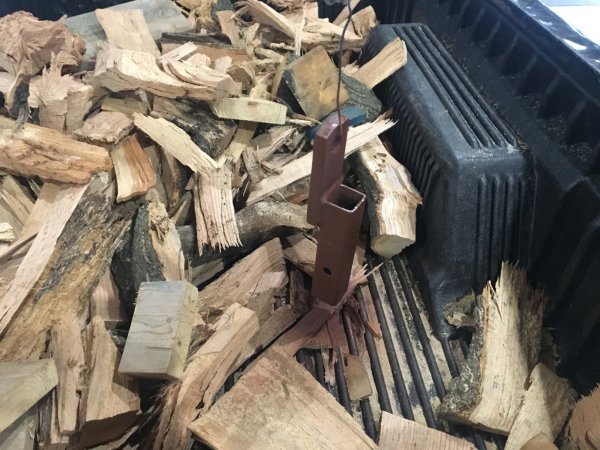

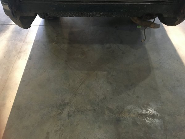

    Figured I’d better do this before the darn thing fell out from under the truck! Gonna order the new one tonight. Came off better than I thought it would. CA3CEBAB-7A8B-4627-97BF-B089DF3EFE7A.jpeg C5585CBC-7DD6-4CBA-A948-A9FDE77C1323.jpeg

    Specific culprit or years of use?

    Opposite order, but yes!:rofl: :lol: I noticed with full loads that it appeared my hitch was “bending” down, butt then returning to its original position when empty. Upon inspection, I found the weld had nearly failed at the end of the square tubing where it connects to the truck frame. I immediately stopped pulling anything and waited for better weather. Since I noticed it, I towed my trailer empty twice and my splitter today. I was so nervous after towing the splitter, that I removed the hitch and ordered a new one when I got home. Not worth it! Already pushed my luck too much:rofl: :lol:

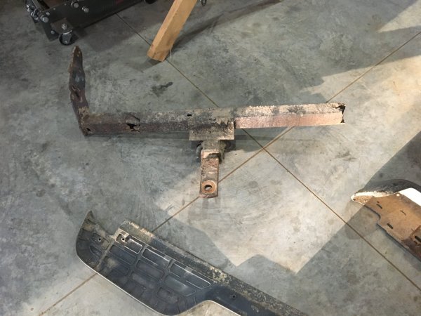

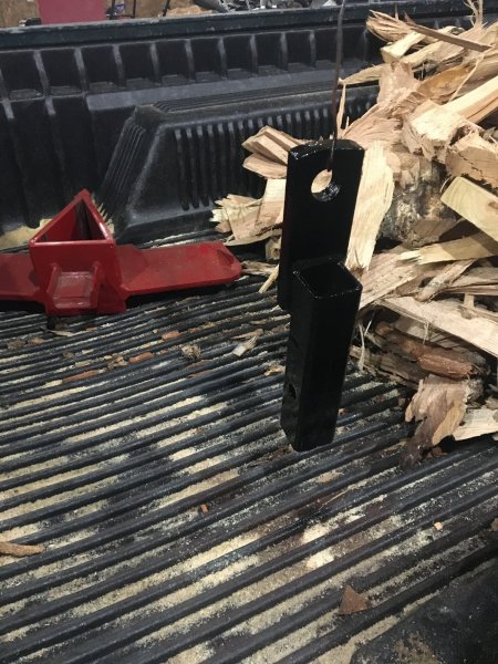

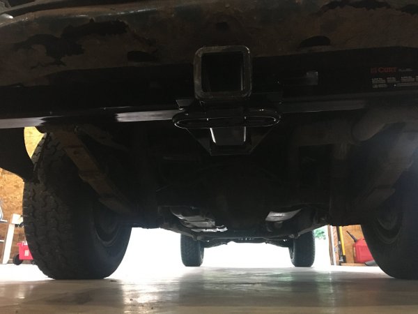

    It sure does make it harder:headbang: Got the new receiver installed yesterday between shifts and got the old hitch cut out of the old reciever this evening and cleaned up with a wire wheel before spraying a coat of primer and then paint on it. Should be ready to go in the morning! Everything went together surprisingly well except for one of the top bumper bolts went in pretty hard. I got it flush with the bumper but was too nervous to torque it to spec. Didn’t want to break it off. Figured there’s 7 other bolts holding the bumper on and I had no trouble with them torquing down:whistle::yes: Glad it’s done now! AAFD0FD3-C4BE-4373-B3B6-0067C9D86617.jpeg B7F4BD51-AA8F-4936-9095-B53AEAA5B078.jpeg ACEDA174-CF41-4672-BB0B-BF6FD10BEDC4.jpeg
