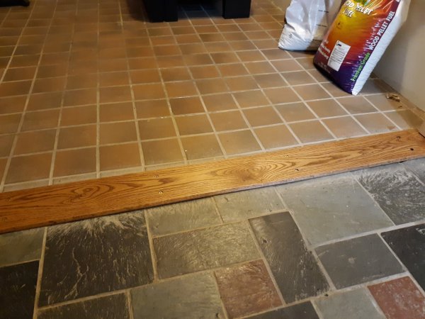

    Lets see if I can explain this so it's understandable...
    Two rooms in the basement with a 6' wide opening joining them. One room has ceramic tile, the other has flagstone. Between the two floors is 4" of bare concrete.
    So... I got a piece of oak and ran it through my table saw to form a "T" of different depth to overlap the floor thickness differences, sank some 1/4 drop in anchors and used brass flat heads countersunk in the wood.
    So far so good...except... there is still a uneven gap along the center where the concrete is and I know repeated stepping will eventually crack my stained and poly'd work.
    So the question is what can I use to bed it to the concrete? I was thinking squirt something down, cover with plastic then screw the threshold back down, let it harden and then remove the plastic. That way it will still be removable so I can refinish it when necessary. Pardon for the appearance of the stone and tile, the previous owner never took care of them and I still need to strip and seal them... 20201223_123526.jpg

    Groute...and use wax paper for the release film...

    I have the same detail between my kitchen and great room. Tile to carpet. Since you did such a good job with yours, any chance you could do mine? The piece of red oak is laying behind the furniture waiting to be installed for a couple years now. Gotta keep a few things on the honey do list or it gets filled up again!
    Good idea with the plastic. Construction adhesive will work. Tape the tile on both sides for when it oozes.

    We're all neighbors in a sense, but that commute is a bit much with the holiday traffic. I was thinking construction adhesive myself, tape on the floor along the edge is a good idea, glad I thought of it.
