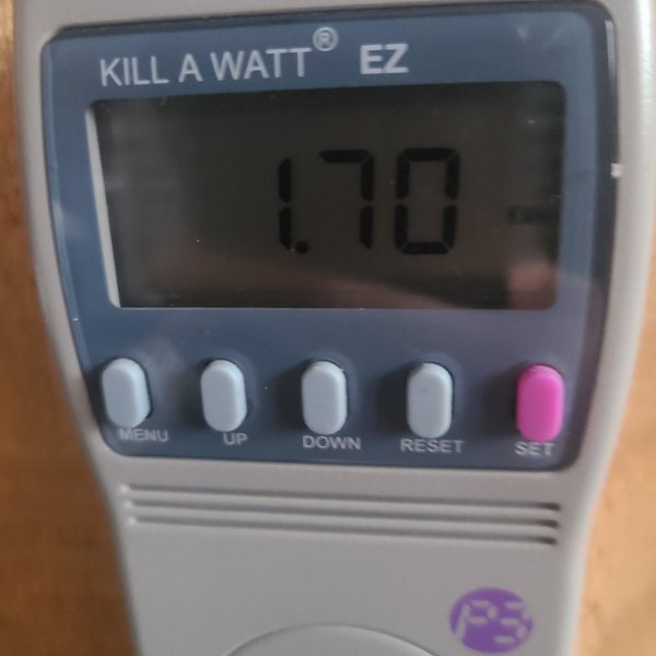

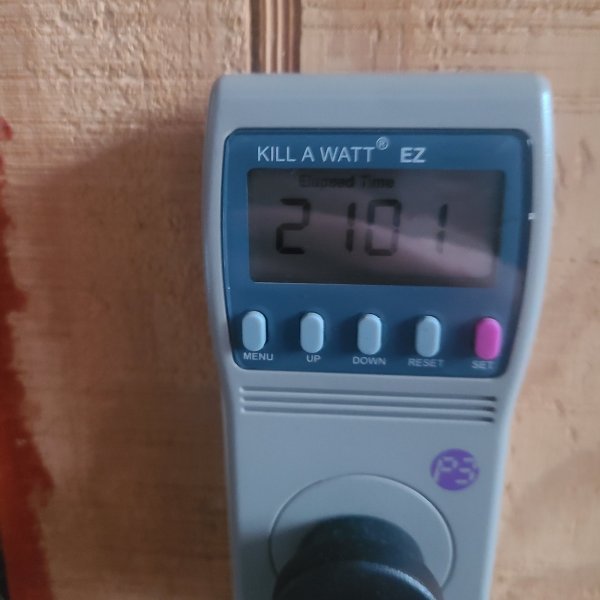

    Stove has been running for 21 hours and it still looks like it would use about 650 watts to run for 8. Longer test than my original but for all intents and purposes is the close enough.
