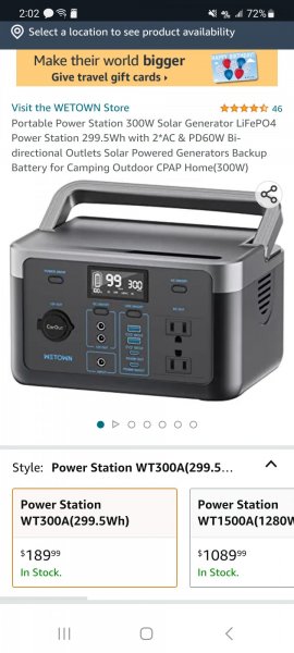

    I may just for fun buy a cheap 300 watt one and see if I get about 4 hours.
    jtakeman likes this.

  16. IHATEPROPANE
    IHATEPROPANE
    Oct 13, 2013
    4,678
    19,115
    Something like this maybe.

    Thats neat! I'd be interested in the test results.
    I'm sure there is away to make an auto switching box that would transfer from house power to that back up with a relay set up. Plus use the ups and its battery as well.

    Yeah, someone with more knowledge than me could probably do that.
    We haven't had an outage here of more than 4 hours in the 12 years I have lived here. So I don't need to get too crazy or expensive with it. Altough the smaller outages have increased in frequency.
