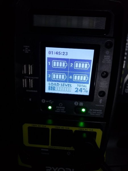

    Yesterday afternoon the Ryobi Power source showed up. Let it charge the batteries overnight. Pic is after I unplugged it this morning and brought it upstairs.
    Later today I will plug the UPS for the P43 into it and see if the stove is happy enough with it to start up and run. Although I won't be able to tell total hours it can really run the stove, the each battery has an indicator for the level of charge inside, so should get a fair idea. Literature says it should be able to run a garage fridge (200w) for 3 hours.

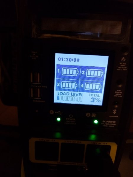

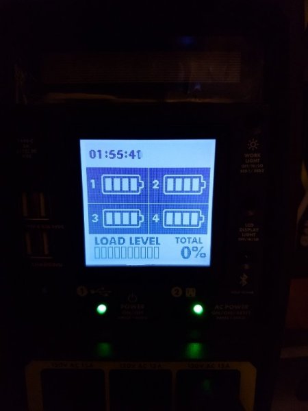

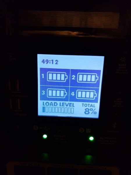

    Yesterday morning, after the stove was cold, I set up the power pack at 4:50, turned it on, unplugged the UPS from the wall socket and into the power packet. Then I waited for the thermostat to call for heat. at 5:25 the stove began its start up cycle. I had the display fully lighted the entire time so it actually used a bit more power than if I'd turned of the light, but it doesn't look like it draws much.
    I didn't even think to look at the power pack readout while the ignitor was doing its thing - so no picture for that
    I finally thought to look at the display part way into the burning cycle (pic 1). At 5:50 it started the shut down cycle (pc 2 was at the very end when only the exhaust was running), and at 6:45 the exhaust shut off.
    Ryobiy backup during running (not start).jpg Ryobiy backup during just exhaust (after cycle).jpg Ryobiy backup after complete shut down of cylce.jpg
    Hardly touched the battery level so yeah, think I could get 10 hours (or more) of straight time running in the deep of winter. And in milder wweather, wehre the stove doesn't have to run very much during the day, I could get longer.

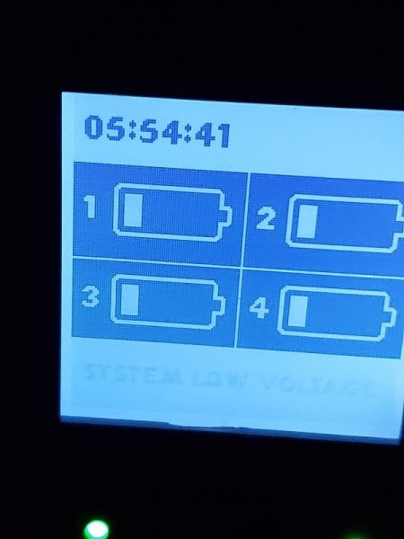

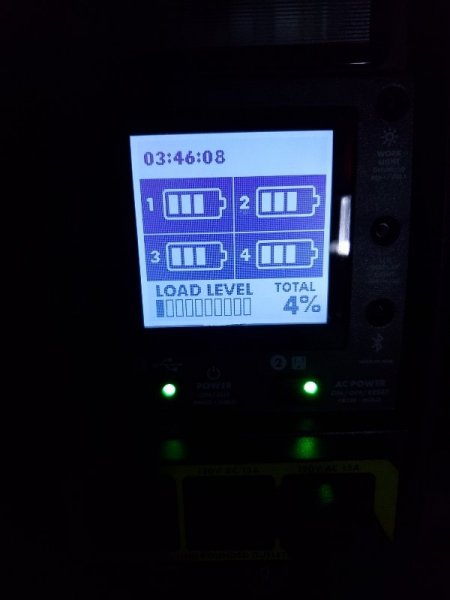

    I got a real world experience from the Nor'Easter. If I run my P43 on the thermostat, I can get almost 4 cycles (start up, heat, shut down) out of the for 40V 6Ah batteries. The first 24 hours of the power outage was a scramble because I didn't have quick chargers for the batteries. And the regular chargers are damm slow (like 4 hours per battery). So I ran up to HD and grabbed a couple of quick chargers and the only other 40V 6Ah battery they had (for a total of 5 plus a 40V 4.0 AH battery I had for my chainsaw).
    Those quick chargers bring down the charge time to 1 hour per battery. So the next 23 hours and 15 minutes weren't too bad. I am lucky that the elderly guy across the street had power, so I could just go over there and recharge easily (I do some care taking for him, so he was happy to help).
    After having power for 13 hours, I lost power again early this morning and I decided to actually track. I started from 4 fully charged batteries soemwhere around 12:30 this morning when the UPS on the P43 started beeping that it wasn't being fed. So, the fire was already started and it didn't have to start the stove. After letting it complete its cycle, and shut down, I hooked it up to the P61a (which it did have to start). This picture was taken right at hookup of the P61a right at start up from cold. So it had run the P43 roughly 1 hour and 40 minutes (say it took 5 to swap to the P61a) and the batteries are still pretty full.
    This pic is after the P61a ran and shut down - approximately 2 hours
    It had to start and run the P43 - which I shifted to a continuous mode to run the batteries out, and I got a little over 2 more hours before the Battery Pack lbeeped to let me know it was almost out of juice
    So, nearly 6 hours of run time, including two cold starts (that really eat the juice up). I may have been a bit optimistic in my initial 10 hour thought, but I'm pretty sure that if I had run the P43 continuously instead of swapping around and going thru 2 restarts, another 30-60 minutes would be added.
    Would it have been handy to have a system such as In the Pines suggests in comment #43? Sure. But it got me thru with heat and that is what I was looking for. This area hasn't had an extended power outage since the 2008 ice storms, so I took a calculated risk to use a system that would be handy in other ways, and it worked pretty well for me.

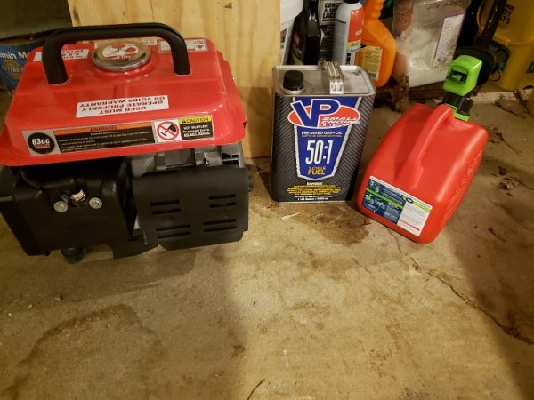

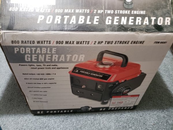

    Expense had nothing to do with how I chose to store electricity. Well, except I was not spending $30k to install a tesla-type 4-day back up that would get used once every 15+ years).
    Even though I shouldn't have to explain my reasoning about gas generators, here it is - this battery pack was a back up plan to my back up plan. I already had a small gas generator that I bought in 2014. It has never been used. Once the storm cleared and I had a place to set it (18 hours after the power went out BTW), I dug it out from under the stairway, went and got the appropriate 50:1 gas to start with. Plus I bought a dedicated gas can for proper pre-mix and 2 stroke oil to add to regular gas once I got the generator running. AND, what did that get me? Nothing, nada, I could not get it started.
    I don't know how many stories I heard of people not being able to get their generators running just in my small town. Some were because they hadn't done maintenance after the last use. Several ended up going out and buying another generator to get thru.
    The battery option I picked was because it would be useful for me in so many ways - running tools I already have, portable so I can use in my shed that was put up last fall etc etc. I was able to set it up immediately, not wait until the storm was over and a space cleared for use.
    Is it a perfect solution, no? But neither was a gas generator (which was not a solution at all). There is no such thing, but a solution that got me thru and that was the entire goal.
