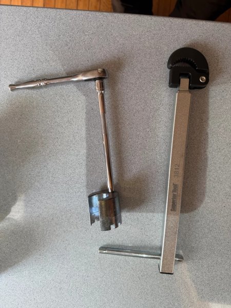

    At the very least, require 2 special tools that cost $50 dollars to make it easier!
    Superior Tool Basin Buddy
    Superior Tool Basin Buddy 1 in. Faucet Nut Wrench 1/4 and 3/8 in. drive Mfr# 3825 - Ace Hardware
    Basin Wrench
    Superior Tool 1 in. D X 16 in. L Telescopic Basin Wrench Mfr# 3812 - Ace Hardware
    The first tool Basin Buddy disconnects the water connection which came off fairly easy but the larger nut that holds the faucet to the sink is rusty and will not budge using the basin wrench, ( a long tool with the black ratchet head to get in the tight space ) even after it soaked all night with PB Blaster.

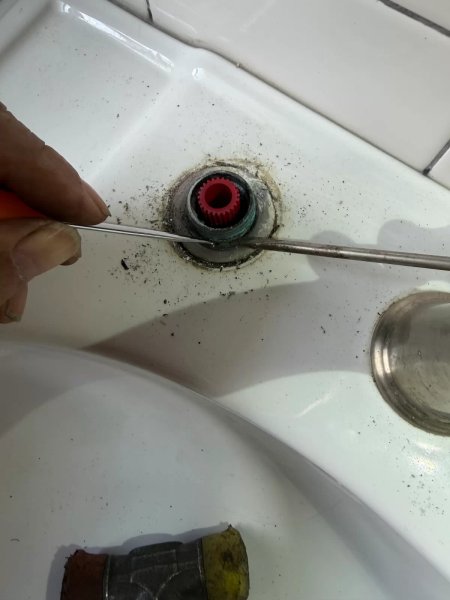

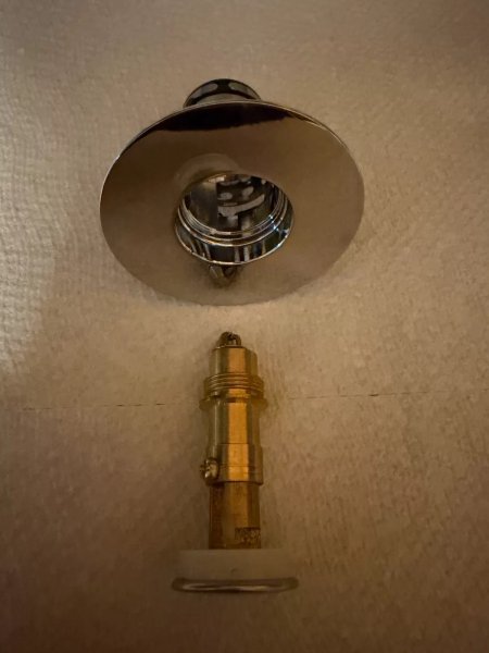

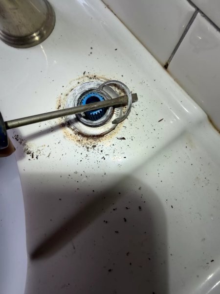

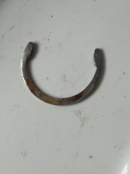

    I also found on this faucet and probably others that after unscrewing the handle shell, the base that holds the cartridge housing is held in place by a retaining ring c-Clip. I just took a hammer and screw driver and using a pick probe tool, I pryed out the clip and pryed it off and the faucet cartridge housing dropped right out!!

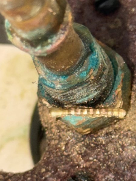

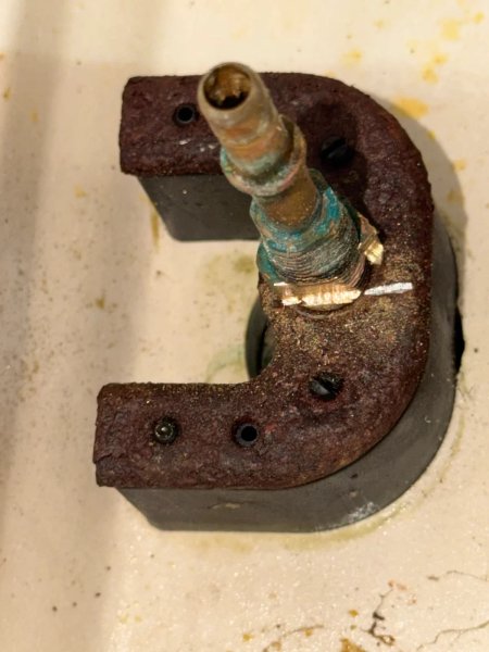

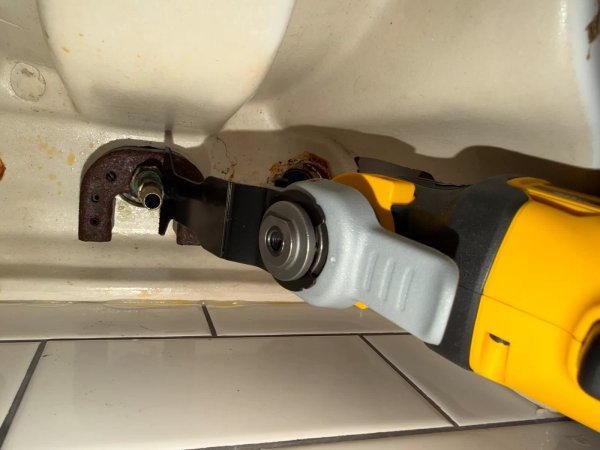

    Taking the nut off that holds the horse shoe which holds the water spout in place not easy. After soaking the brass nut overnight with PB Blaster it still would not budge. Luckily I found a DeWalt Oscillating Multi Tool on sale and only one Lowe’s in this area had one left! It was the Tool, battery, charger, 3 cutting blades, 3 sanding blades and sanding pad holder, and cutting guide. Reg Price $259.00 on sale for $119.00

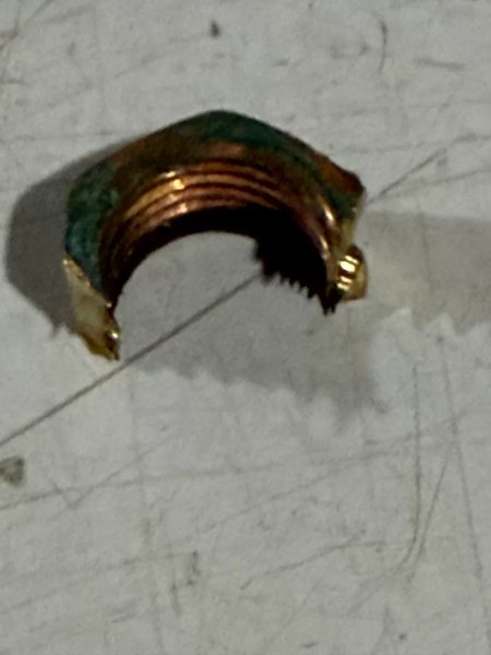

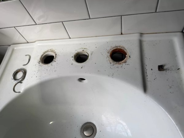

    Therefore with this tool, it just bearly fit in the space to cut the brass nut that holds the water spout! So I made 3 cuts on the corners of the nut and the rest of it just fell off and the spout could be removed!

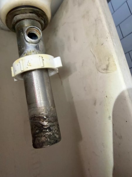

    To remove the old drain pipe to install the new pop up drain
    1. - The trap was unscrewed to disconnect it from the sink too.
    2. - 2 bolts that connect the sink top to the wall studs were removed.
    3. The sink top was lifted off to remove the large drain nut.
    Good news - the space is tight under the sink drain but having the right size channel lock pliers and while holding the drain pipe, the large nut was easy to remove! Now the new style pop up drain can be installed!

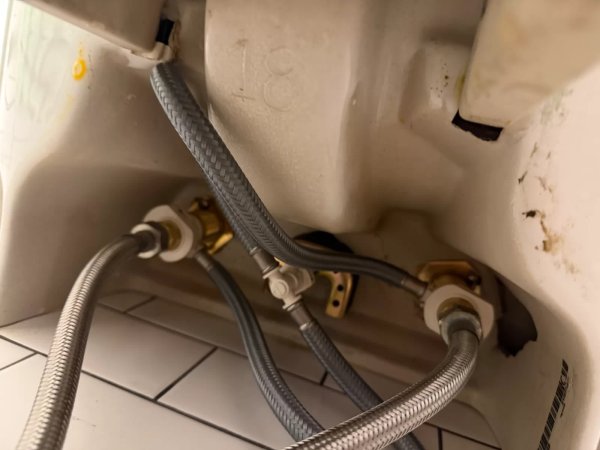

    Then just install the new faucet and connect the water supply. All done!

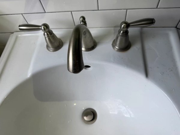

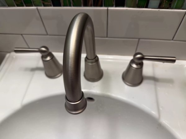

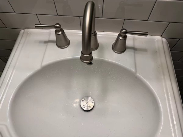

    Pic 1 - Moen 3 hole lav faucet
    Pic 2 - Superior Tool Basin Buddy with ratchet & extension and a Basin wrench.

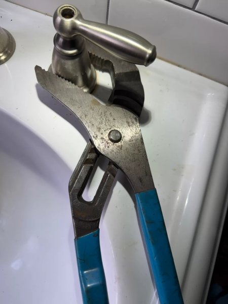

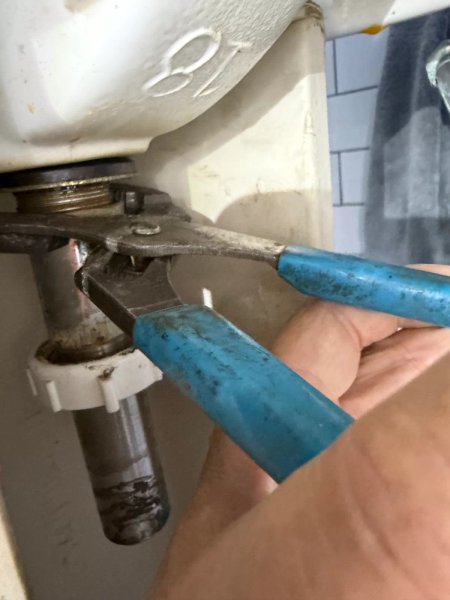

    Pic 3 - unscrewing handle body with channel lock pliers
    Pic 4 - Prying out retaining C-Clip
    Pic 5 - Pulling out retaining C-Clip
    Pic 6 - Retaining C-Clip

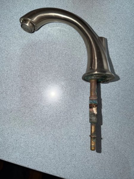

    Pic 9 - Brass nut and horse shoe holding water spout shows first cut
    Pic 10 - Nut that will not budge that must be removed
    Pic 11 - DeWalt oscillating multi tool just fits up there!
    Pic 12 - Water spout is out that shows where the nut was sliced off.
    Pic 13 - Faucet removed!
    Pic 14 - The nut that was cut with the oscillating multi tool. What is left of it! :)

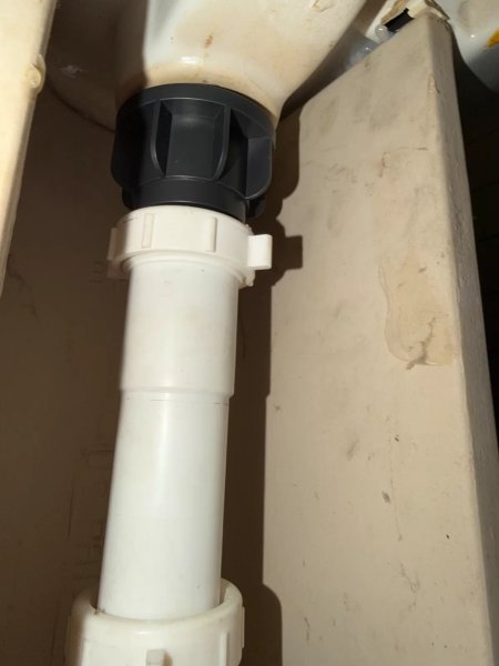

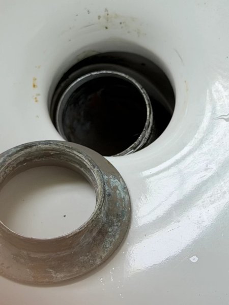

    Pic 15 - Drain pipe that must be removed to install the pop up drain.
    Pic 16 - Channel lock fits and enough room to loosen it!
    Pic 17 - Drain pipe and ring is out!
    Pic 18 - New pop up drain waste gate pipe below the sink
    Pic 19 - New pop up drain inserted into waste gate flange.

    Pic 20 - Faucet and Popup Drain
    Pic 21 - Faucet underside Complete
    Pic 22 - Faucet Close Up

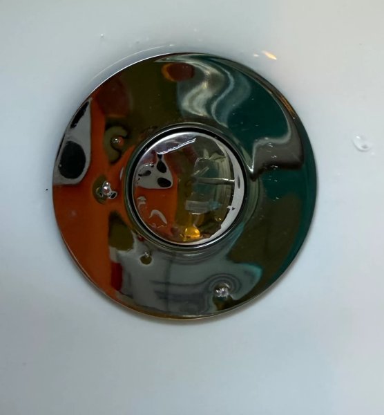

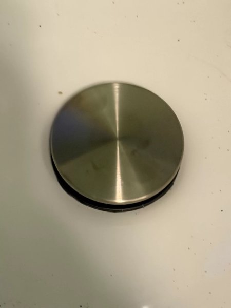

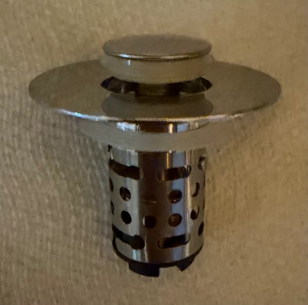

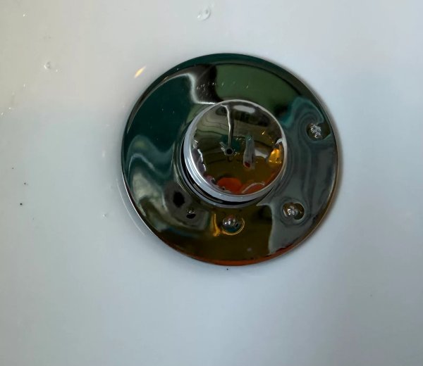

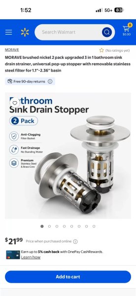

    Just upgraded from the pop up to the push down drain stopper with the hair and lint trap.
    Pic 23 - Push Down Faucet Description
    Pic 24 - Push Down Faucet Assembled
    Pic 25 - Push Down Faucet with top unscrewed for easy cleaning
    Pic 26 - Push Down Faucet open for draining :)
    Pic 27 - Push Down Faucet closed for filling
