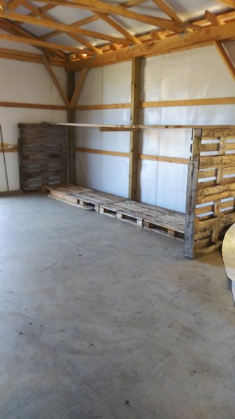

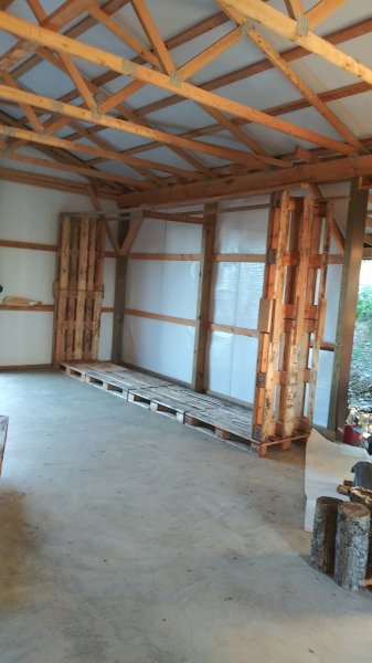

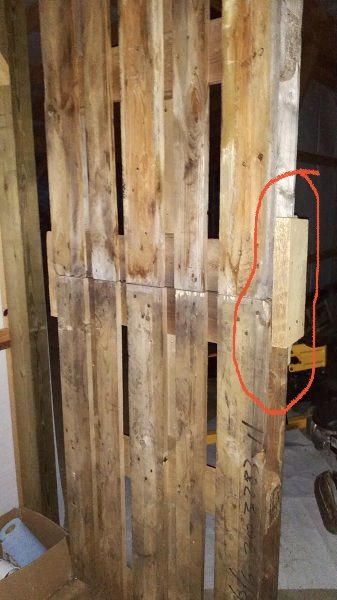

    So, I started the day building this..
    But that only allowed for 58" of height.
    (194" x 58" x 31.5")
    A third pallet wasn't really an option, as duals they're heavy enough manhandling alone, a third would be way too much.
    So.. I tore it all apart and started over.
    This is the final result..
    177" x 94" x 31.5"
    This will allow me to stack 2.5 cord of wood in there, and it's quite solid.

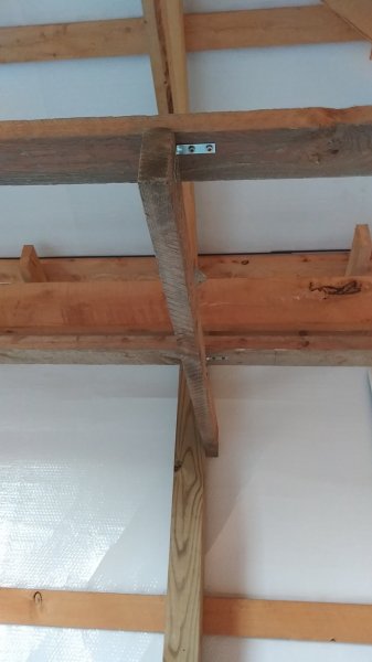

    Not intending to load it to the top, I also intend another center brace tying the top rails to the 4x6 post.
    I can add additional bracing on the bottom sections.
    I need to purchase some 16 ft 2x4's to make a second rack, I can also add a third top rail if necessary.
    Thanks for the input.

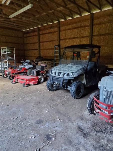

  11. brenndatomu
    25,309
    164,763
    That building has so much untapped potential...I'd love to have that!
    I'm stuck with an old 18x28' concrete block building that has the overhead door in the 28' side...so it's not deep enough to pull anything much longer than a Bronco II :hair:...getting ready to add on to it...should have done it years ago before the prices went koo-koo though!

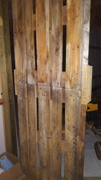

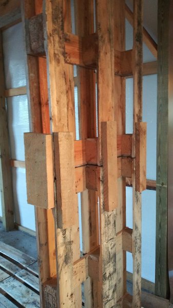

  16. Chaz
    Chaz
    Jan 27, 2018
    8,753
    62,087
    Southwestern NY
    Hey guys, I actually am quite happy with how things turned out, and I think it'll make a great prototype for the outside racks.
    I think that it would be good to add a plywood "scab" on the internal meeting joint. It would add a fair bit of strength to any bowing outwards.
    There is already outside wood tying the pallets together, as seen previously, but some plywood on the inside would add substantial strength at the joint.
    Keep in mind, there will be 2 of these, connected across the top for additional stability.
    Thoughts?

  19. huskihl
    huskihl
    Jan 30, 2016
    3,728
    21,484
    Plywood on the inside won’t do much. I would remove the short scabs I have circled and replace them with full length 2x6 that go from the floor to the trusses on each side of the pallets. And screw the chit out of it
  20. eatonpcat
    10,373
    59,279
    Good advice here!
