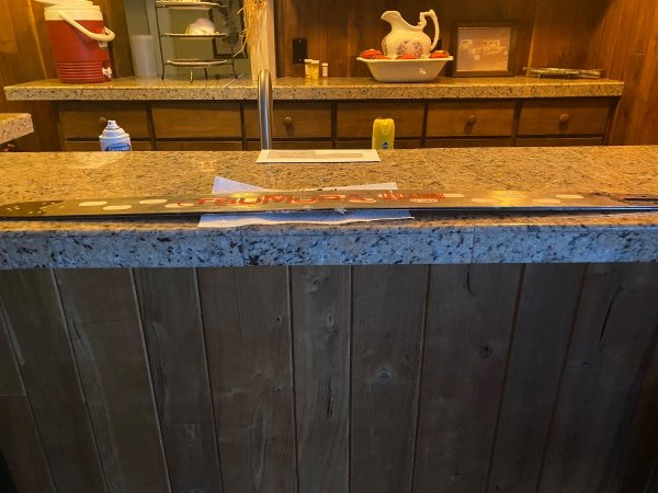

  17. Hinerman
    Hinerman
    Oct 9, 2013
    680
    2,865
    NE Oklahoma
    I bent a 36" bar; took it to a machine shop, they straightened it like new with a 50 ton press. I told him to give it his best shot and not worry about ruining it because the bar was useless like it was anyway. I was impressed; I did not expect to ever use the bar again...

  18. Dakota Hoarder
    Dakota Hoarder
    Jan 8, 2017
    1,554
    9,094
    Sioux Falls, SD
    Wow that’s bent way worse than my 32”. I still can’t get it bent back after putting 2 2x4 underneath and jumping on it.
