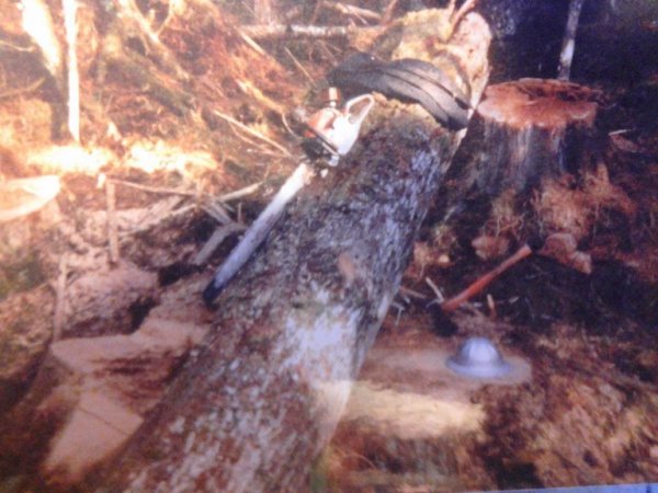

    The stump my hard hat is sitting on is an ancient yellow cedar. It was 96" at the wide point perpundicular to the face. I fell it with my 044 Stihl Madsen modified with a ProTec filter. Pulling a 34" Sugi Hara bar with Oregon 75 CK with a 7 tooth. . The tree my saw is dogged into was around 48" on the stump. Fell with the same saw, bar and chain . Chisel ground chisel chain.
    I've fell a few ship loads of timber with 4 cube saws with 30, 32 + 34" bars. And made good money doing it. 082800_114202.JPG
    The stump I'm standing on is a Sitka Spruce fell with a 372 Husky , 32" Oregon bar Stihl 3/8,063 Semi Skip. Chisel ground chisel chain . With ( get this ) an 8 tooth rim sprocket. Stump was about 50 "
    A 372 will pull a 32" just Great. A 30" is kinda perfect tho.

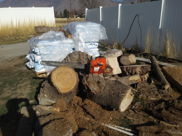

    It came today!!:faint::bug: 0C39DFA5-D4D2-4DDA-A2F4-86DF88B9A998.jpeg
    eBay find 28” used husqvarna bar and I picked up a new full skip chain too.

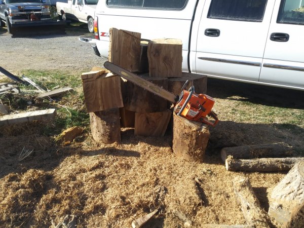

    Just make your own reduced weight bar. I picked up this 32" Power Match for free, dressed the rails, stripped the paint and got busy. I used a carbide hole cutter, lots of thread cutting oil, a right angle grinder, and a few bucks worth of two part epoxy. The inside edge of the cutouts I beveled on both sides, to act as a mechanical fastener.

    Which brand of epoxy did you use ?
    Looks like it is not affected by the heat.

    Whatever Harbor Freight sells. I knew I would use a fair amount, so I went with the inexpensive product.
