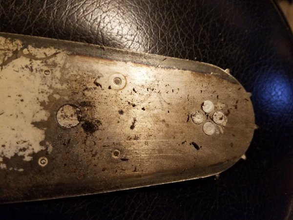

    20161101_133339.jpg If you look at the two blue lines they are very even. I have had this bar since new and I know it has never been hot enough that I couldn't grab it with a bare hand.

    What brand of bar is on your saw that comes blue like that?
    From playing around with my rivet forge, I learned a few things about heat treating and tempering. The steel would need around 1400 F or more to harden followed by a quench. The steel is then quite brittle, so that's where the tempering comes in.
    If you wanted the part to be harder for less wear, wouldn't you keep the tempering temp lower? Blue is considered fairly soft for steel isn't it?
    Is it only case hardened, or is it the same color inside the bar rails?

    I think the TTT curve is going a bit off the path from where I'm sitting. All I'm saying is, that no matter the hardening temp, or the amount of carbon in the steel, the blue/brown/straw/gold color indicates a specific temperature that the metal has been subjected to. Obviously blue rebar would be softer than blue my truck leaf spring.
    But my thinking of hardness is related to knife blades, not to chainsaw bars...maybe blue is soft for a blade, yet hard for a bar?:eek::confused:

    If memory serves to turn low carbon (.08%) steel blue it has to get to around 500° F. I cannot fathom a saw bar getting close to that, even milling. 200°-250° maybe but 500 is HOT. I was thinking carbon has an effect on the coloring temp but not much maybe 20°-50°. Unfortunately I sold that book when my class was done so I would have to use googlefoo. My main point was the blue on bar rails was from the induction hardening process not useage. Wikipedia turned this up.
    If steel has been freshly ground, sanded, or polished, it will form an oxide layer on its surface when heated. As the temperature of the steel is increased, the thickness of the iron oxide will also increase. Although iron oxide is not normally transparent, such thin layers do allow light to pass through, reflecting off both the upper and lower surfaces of the layer. This causes a phenomenon called thin-film interference, which produces colors on the surface. As the thickness of this layer increases with temperature, it causes the colors to change from a very light yellow, to brown, then purple, then blue. These colors appear at very precise temperatures, and provide the blacksmith with a very accurate gauge for measuring the temperature. The various colors, their corresponding temperatures, and some of their uses are:
    • Faint-yellow – 176 °C (349 °F) – engravers, razors, scrapers
    • Light-straw – 205 °C (401 °F) – rock drills, reamers, metal-cutting saws
    • Dark-straw – 226 °C (439 °F) – scribers, planer blades
    • Brown – 260 °C (500 °F) – taps, dies, drill bits, hammers, cold chisels
    • Purple – 282 °C (540 °F) – surgical tools, punches, stone carving tools
    • Dark blue – 310 °C (590 °F) – screwdrivers, wrenches
    • Light blue – 337 °C (639 °F) – springs, wood-cutting saws
    • Grey-blue – 371 °C (700 °F) and higher – structural steel

    The discoloring on bars I am referring to is extremely dull chains burning the bar from extended pizz revving attempt to punish the wood by dogging in said dull chain in a last ditch effort trying to get it to cut. At that point, no amount of oil is going to make a significant difference.
