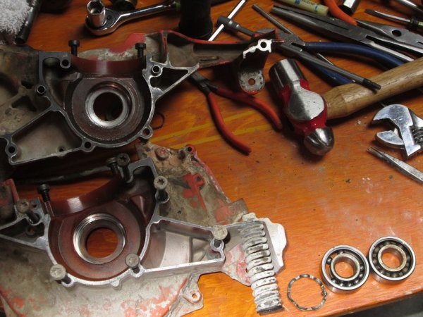

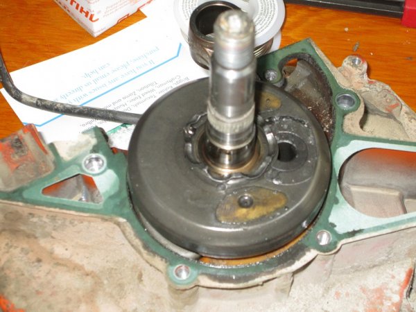

    That looks like a Husky with crank stuffers.

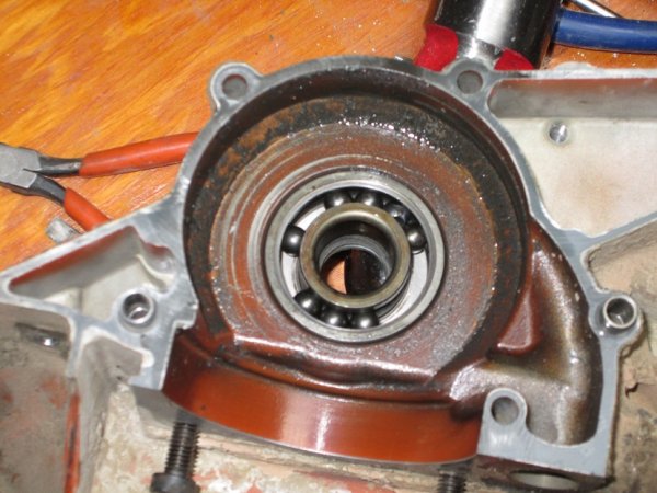

    This is a husky concrete saw I rebuilt.

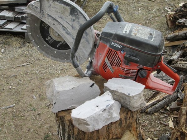

    Rock and roll.

    Improper air filter maintenance contribute to that one you think?
    I always cringe when I see guys grab the AF and blow it out but pay no attention to all the 'crete dust that fell into the airbox/intake while they were fooling with it. :picard:

    The bearing that was bad was on the PTO side and I think it was a lack of oil. I also saw some discoloring on the rod to crank journal from to much heat. So I replace the crank and rod too. The only thing I kept was the piston and cylinder, everything else got replace. I got the saw for free because the owner did not want to spend the money to repair it. I still have the saw.

    Definitely was not dusted then...that generally wipes the top end too...

    You are right it is amazing how much of that concrete dust gets into the filters on these saws.
