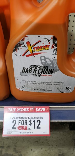

    This was last year
    TSC shelf
    and Rural King ad.
    I'm guessing that with political winds shifting and the upheaval in the middle east, we won't be seeing these prices again...
