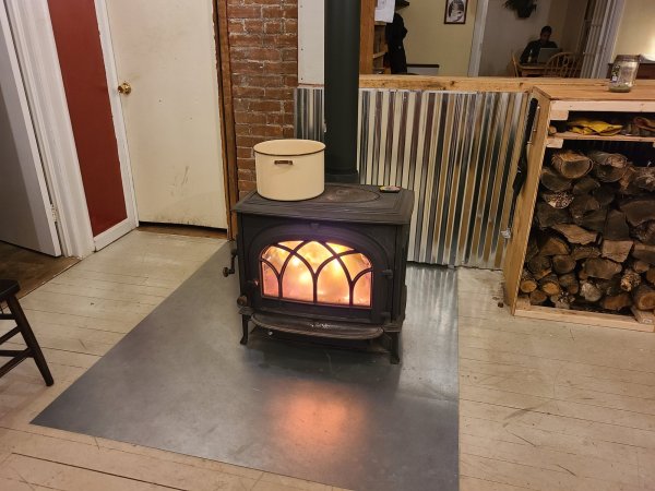

    Part of the purpose of this bar sits atop the remains of a wall that was a whole wall, now a half wall. It will be a place to set grocceries, boxes of food and the like, as well as an eating surface near the kitchen. (Behind the roofing steel and wood bin in the pic). 20210118_191506.jpg

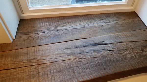

    I made a barn wood cabinet top at a window in our mudroom. Several coats of poly and no issues. Didn't fill holes or cracks either.

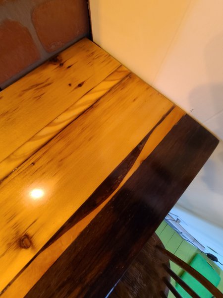

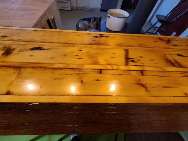

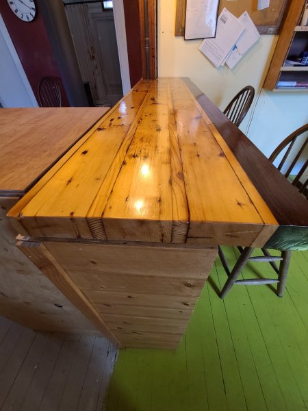

    So to date, i used about a quart of poly, filling holes and voids. I caulked holes and voids from the under side, and filled them from the top w poly-u. Poly shrinks when it dries...some voids were over full, and now are concave.
    I have 2 finish coats on it, with a few more to go.
    The wood is whatever very oldschool 2x4's came out of the kitchen cieling (so fir?) and a chunk of wallnut that was here layin around. In between the 2x4's is pine stripping also repurposed from the old hung kitchen cieling.
    I kinda like all the voids and holes, and I wish I hadn't sanded the wood from it's "aged patina" if one can borrow the term for woodworking. But the wood was a bit warpy, and the glue-up was not 100% perfect. So sanding just to get a flat surface was necessary.
    Wood filler would have sanded out much better, as far as a flat surface. The poly-u holes are harder than the surrounding wood, so I had to work hard to keep the surface flat when knocking down built up poly u around the edges of the holes. But, if one were to shine a light down into a void, one could still see the sides of the void through the poly. (Pic).
    I do wonder if something like fiberglass resin would have worked better, the holes would have filled quicker, but I know nothing of sanding or the finish quality of that stuff.
