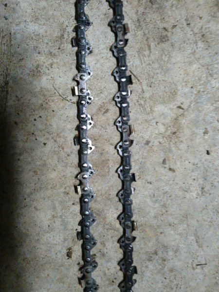

    Unless I am seeing the picture wrong, the rakers look too low on some cutters ............. and those cutters do look dull.
    Is looks like it could be too grabby and stopping due to the low rakers - any way of getting a picture of the whole chain on the bar from the side so the rakers are clear ?

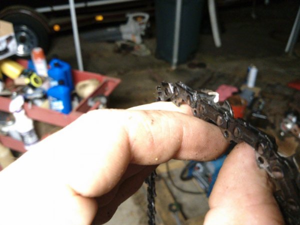

    IMG_20141013_214542_256.jpg Ok since were all so involved...here I am grind I chains at almost 10pm!!
    For those who asked the rakers are close enough to .030 for government work. But seriously they are just below the .030 mark on my gauge.
    A pic of the chain as it came off the saw tonight.

    I looked around. Couldnt find a file small enough to hand sharpen. I had one bit not sure where it went??
    I did grind it. And I can tell it helped it hopefully thats the problem??
    Although I will say this...I hate to admit but I have cut plenty with chains way way duller than this years ago. And I never had anything g like this happen. But this is really the first saw I have uses much under 60cc so maybe its a small saw thing??
    And I looked in my stash. The only other 14" chain I have is a 52dl chain in oregon vlx or whatever out is...for the earthquake. Stihl 14" on this bar takes 51dl.
    A terrible pic but I worked to get this one. Of the ground cutters
