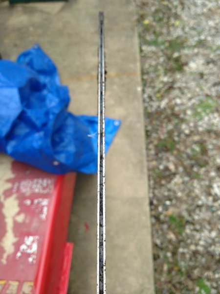

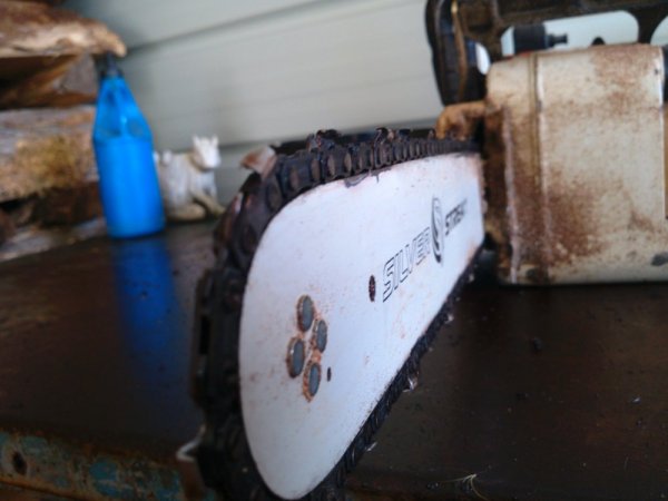

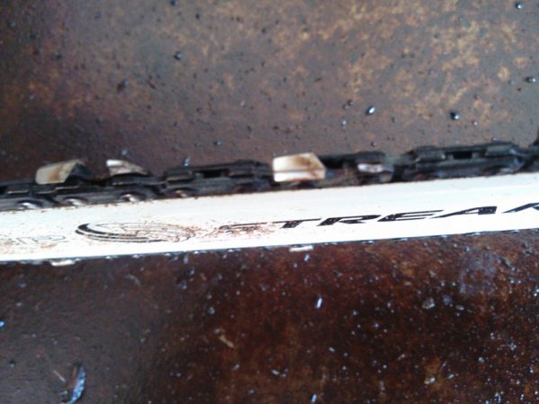

  9. clemsonfor
    clemsonfor
    15,996
    37,478
    Greenwood county SC
    The first is a pic of the old stihl bar.
    The next one is the new bar. U can see where I guess it got hot and burned the paint off near the tip IMG_20141013_132352_260.jpg IMG_20141013_132509_643.jpg IMG_20141013_132448_863.jpg
  10. Butcher
    Butcher
    Oct 3, 2014
    1,071
    7,238
    Might be a stretch but this chain you are running, was it bought from a shop that makes them up from spools? and then puts them in the boxes that the chain mfg. supplies with the chain? Could be some one mis labeled the box?
  11. clemsonfor
    clemsonfor
    15,996
    37,478
    Greenwood county SC
    Got it from jim goodall supply. They have a website bit I got it off ebay. It was in a zip bag with a label I think. Not an original package. Chain was new..think forester? The other chains from there were boxed...its possible they made this one up?
    I need to get calipers out and see the width on it.
    The chain is as it was on the bar as I used it. If anything just a tad looser than I tighten too. But not close to jumping off or being too loose.
  12. bogydave
    How does it cut when first in the cut , before it locks up?
    Maybe a real dull chain or the rakers are to high ? (or both)
  13. concretegrazer
    concretegrazer
    4,429
    12,455
    Southwest MO
    I see a dull chain. Time to sharpen.

  14. clemsonfor
    clemsonfor
    15,996
    37,478
    Greenwood county SC
    It throws chips fine until halfway through the cut.
    I agree grazer it would benefit from a sharpening but dont think thats the problem. It cuts decent half way through.
    If I can I will throw it on grinder and try again. Wish mail order wasnt Bout my only option for a new chain...id like to see today what a new one would do?

  19. CTYank
    CTYank
    Oct 2, 2014
    360
    850
    CT Panhandle
    About the sharpening thing. Best thing for you and the saw is to learn how to file a chain, ideally with guide like Granberg's.
    Then touch up the cutters at every other fill-up. Continuing to cut while waiting on pulling the chain & grinding it, is way sub-optimum.
    Keeping chain sharp makes life much easier on bar & engine too. Filing takes off much less metal than grinding. Much less.
    Yea, that chain is not looking good.
    Edit: I should add also FORGET FULL CHISEL, most especially with your weekly grinding shtick. Stick to semi-chisel.

  20. Shawn Curry
    Shawn Curry
    Jul 31, 2014
    3,755
    22,702
    Western NY
    Same chain on two different bars, gotta start suspecting the chain at this point. As rough as that sucker is looking, gotta think sharpening the thing is at least worth a shot. Sure looks like a dull chain to me.
