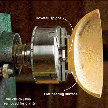

    What about these different chucks I see available for bowls/projects? Worth the purchase? Can you remove it from one piece to start another and then replace it one the original piece with the same precision?

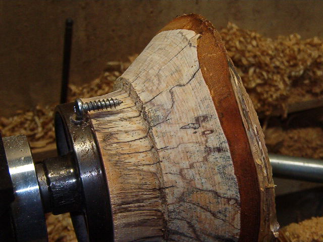

    The screw-on type face plates are much cheaper than a jawed chuck, but the jawed type are much easier and precise for remounting the work. But, you might be able to buy several of the screw on type for the same price and just leave them attached. You can spend an awful lot of money on specialty tooling; Id take a "wait and see" sort of approach to what you think you might need.

    I found this thread 15 min. before I had to leave for work so I'll respond later. In the mean time, check out this link. Penn State Industries | Pen Turning | Pen Kits | Dust Collector I'd highly recommend choosing a chuck. The screw on face plates require you to loose a lot of material due to the depth of needed screws.

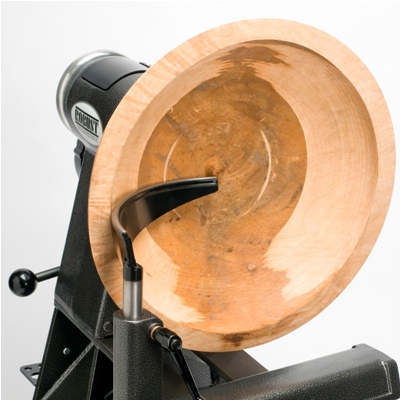

    Tooling is key w/ a lathe. This is where you blow the budget. One thing I do not have but want/need is this tool rest.

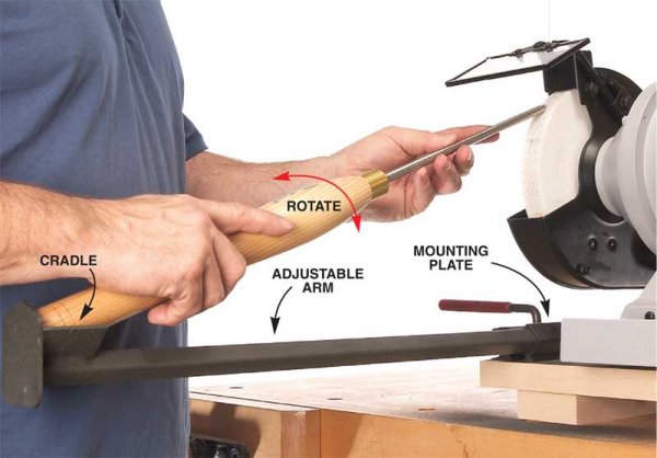

    And a sharpening system is a must. Tools loose a fine edge quickly and performance drops off. Haven't tried this but will soon.
    A jig for guiding tools on a grinding wheel. My pop and I have been using bench belt sander w a fine grit to keep tools sharp, and he has a multi-shaped stone.
