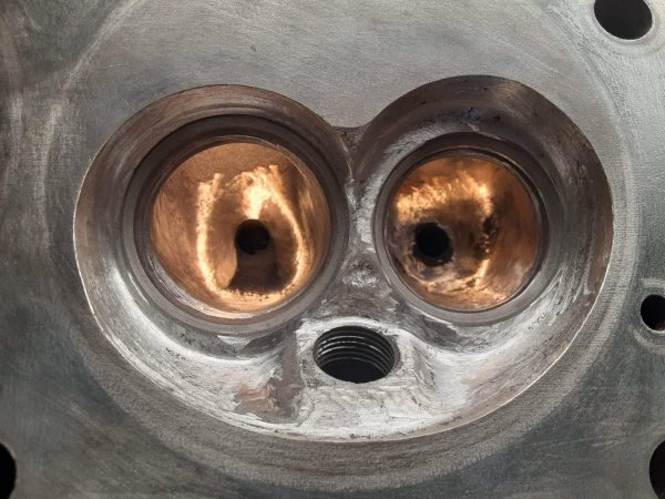

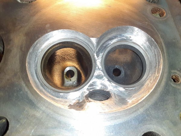

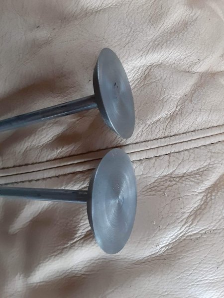

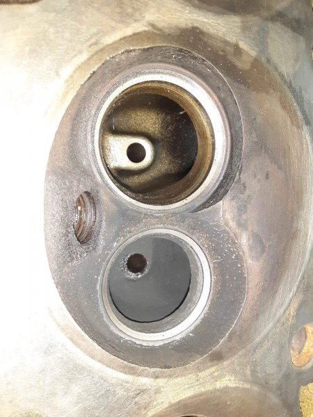

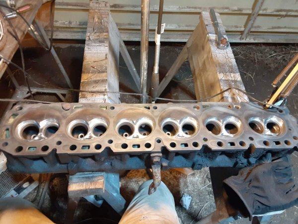

    Made some progress on the grinding today. The combustion chambers ate done and the bowls/short sides are also done. I will do the valve guides and air injection humps tomorrow. I made up some dummy valves to protect the seats. They worked great. A fan was beneficial in keeping the grinding dust out of my face. I also set up one of those lamps like they have in the pixar intro. The peg fit perfectly in the head bolt holes so I could swivel it around as needed.
    Here is the progress so far.

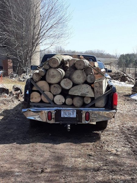

    I hauled a load with the truck yesterday. We were visiting family for easter and they sent me home with a cord of maple/elm. The first real load with the new head gasket.
    It stayed nice and cool, even through the long steep grades. We split and stacked the wood today and it measured out to ~120 cu ft without the short pieces I am going to split into fire starters. So what you see on the truck is a full cord of wood, minus a couple of rounds.
