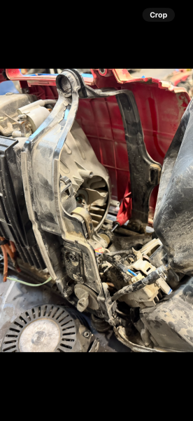

    IMG_4355.png It’s been a day for pull ropes here today. 3 of these showed up last night. I will only use True Blue in this application. I also tell the guys if it dont start in 6 pulls you can yank on that thing all day and it’s probly not gonna go, stop and figure out whats wrong or find someone that can.
