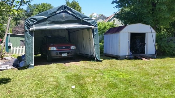

    I've had a 13x24, used Shelter Logic, heavy cover tent garage for 3 years. I bought it from a friend who was putting up a real garage for his business. He did get a new cover for it before installing ($800 for the shed, new cover and install). I believe he had had it for 7-10 years.
    It is the regular peaked-roof style and if snow builds up (not often) I take a roof rake and CAREFULLY push up on the fabric and is slides right off. Only use I've had for the roof rake since putting the metal roof on my house (I think I only had to do that winter of 2017/2018).
    The only problem I have is the ground gets really soft, and where it is situated, it faces the prevailing wind that comes howling down a straight street. Although I had steel cable ties shot into the ground to anchor it, the legs have spread a bit, making use of the roll doors impossible now. If I had had a pad installed, most likely that wouldn't have happened. That isn't a real big deal to me, it still keeps the snow and frost off my truck and has a ton of pellets in it. Suggest
    I was worried about the looks, but being green, it is less intrusive than some of them out there. It also hides the rusty metal shed that was there (moved the shed over). Picture taken in July 2017 just after it was installed.
    It should last a good long time (unless I decide to have a real garage built) and was well worth the $800 I spent. Oh, and bonus, One of the few things I didn't need a permit to "build" and I don't get taxed on since it isn't a "permanent" structure.

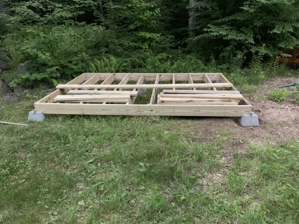

    62BF17D6-F607-42CD-B0E6-1F21439436EE.jpeg I realized the measurements were off on the left side after I took the pic. They have been adjusted.

    That’s a good start!!
    If you measure corner to corner it will tell you if square

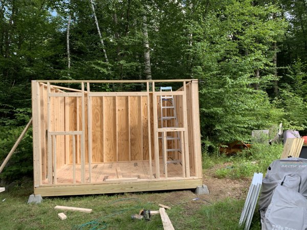

    14F61D80-7A35-4CC2-8066-258BB10CF949.jpeg Moving along...
