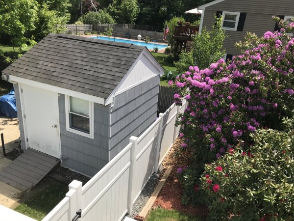

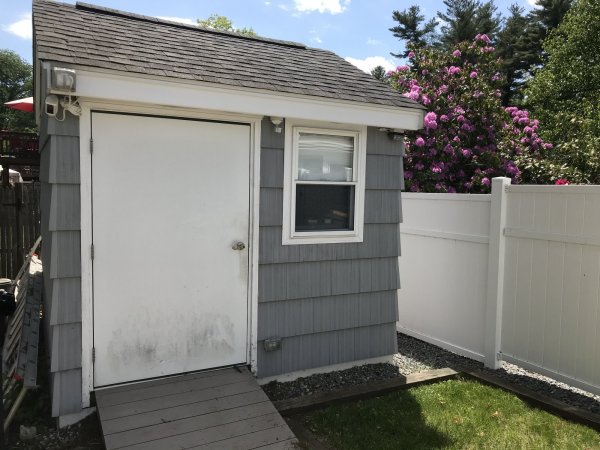

    My 24 x 42 house was built on cinder blocks 58 years ago. In my experience it all depends what the blocks are sitting on. My house of course has a cement footing a little ove 2 feet below the ground. In the case of my 10x10 shed, I dug 2 foot holes and filled them with 3/4” stone with a concrete block on top in each of the 4 corners and in the middle of each side. The floor using 2x8s was built on top of them with a 4’ wide heavy duty metal utility door on hinges that still opens and closes fine after 7 years!
    Also during the build we did a 1/2” overlap of the roof with the rake boards to tuck in some rope light for a nice look at night!! Lol

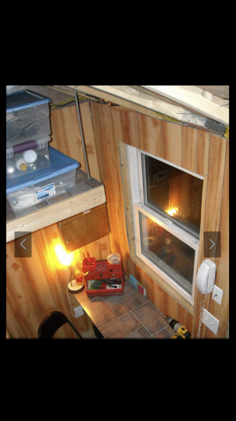

    I installed 2 three way switches one in the shed and one in the house but then put a motion detector on the shed for convenience. Then put A ring camera on the corner for a good backyard view.
    The window is not a shed window but a normal size double pane we got at the Habitat homes restore for very cheap price for that more homy look!!

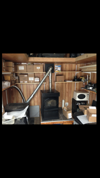

    I did run cable and telephone wires along side the electrical so yes a Phone and cable TV and installed a pellet stove with remote t-stat so it will not be cold when going out there in the winter.
    The walls and roof are insulated and paneling and shelving up on the wall. Even put rigid foam board under the plywood floor so our feet would not be too cold in the winter.
    Also we used an LVL in the roof to avoid cumbersome collar ties so the loft is much more roomy. :—)
    The LVL is supported with an extra 2x4 at each end that goes down to a cement block and 2 foot deep holes filled with 3/4 stone.
    Just some tips and tricks. Good Luck with your build. :)

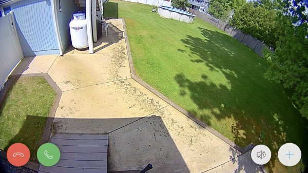

    Nice Shed Don...That Amerigas tank makes me cringe, Bunch of crooks!!

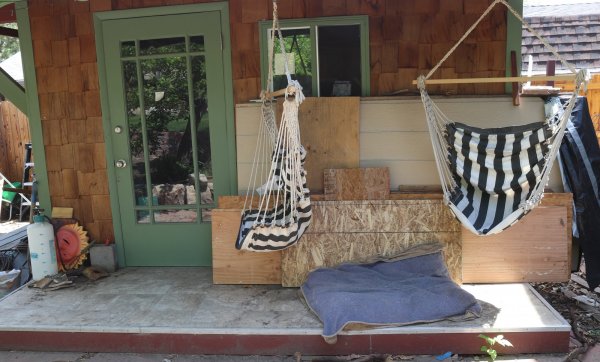

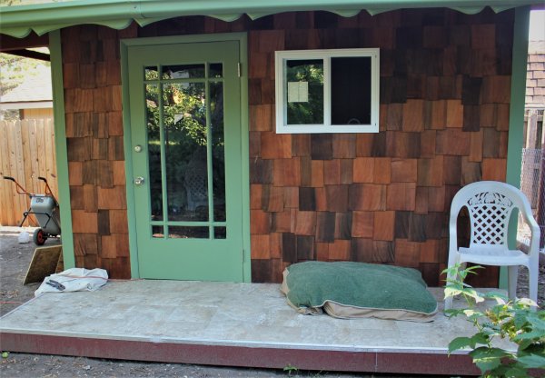

    I built my 10 x 12 shed for $1200. It has some "extras" ....NO other shed has.
    For instance, custom cedar siding. Off set roof line. Scalloped fascia trim.
    A cantilevered, covered porch w/ swing chairs.
    Great place to sit a spell and watch the garden grow on a hot day. Always in the shade.
    A covered loading deck w/double doors.
    On sale....how could I pass it up?

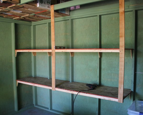

    Floating storage shelves.
    Satisfaction of doing it myself.

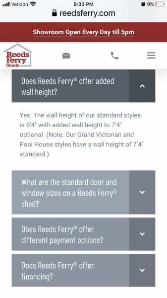

    Codes may be a little different in CA
    Standard wall height is 6’4”
    Optional height is 7’4”
    Premade Shed Door height is approx 5’ or 6’ not sure exactly.
    So no standard 80” high door on many premade sheds. Remember and 80” door per code needs a proper header and top plate and it has a threshold.
