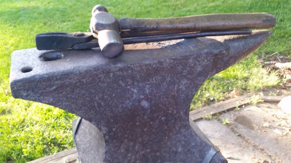

    I did burgers and blacksmithing this evening. I wanted to use the small anvil, one hammer, one tong and one file. Simple, right?
    Burgers were great over charcoal.
    Carbon steel not so great. After about 8 heats, it cracked a good size chunk off. I was forging at bright yellow to the point it was mildly sparking coming out of the forge. Not far from forge weld temp. Maybe it cooled further back and developed a crack when striking. I gave up at that point. I need more practice on higher carbon steel.
    It's feet up and sipping an iced tea on the porch watching the sun set.

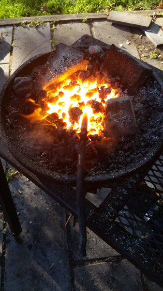

    I used the leftover coals from the grill to get the forge going and added more charcoal and a little bituminous coal. It was hot.

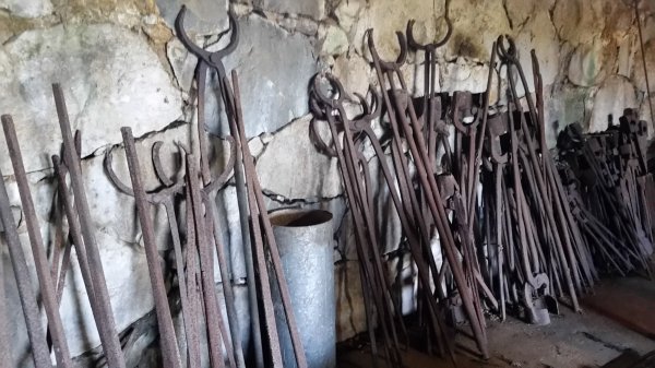

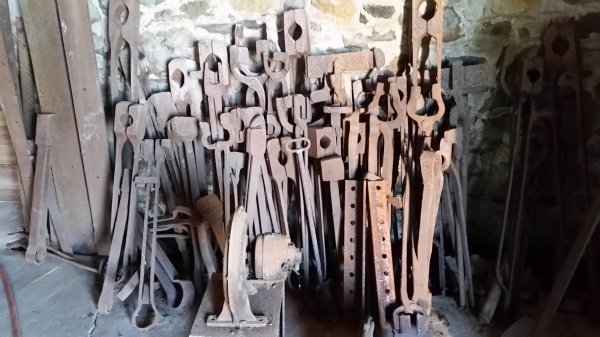

    A little iron eye candy today. A local farm was having an estate sale of two generations of blacksmithing and foundry equipment. All the gear was much too big for what I do, but it was awesome looking at the goods.
    Most of this is for blacksmithing. All the tongs in the following pictures were between 2-5 feet in length.
    These look to be crucible tongs. The middle one was about 6' tall.
    Here is my son next to one of the taller ones. No photoshop here. Real deal big gear.
    This is the largest collection I have seen of large tongs. It was quite impressive.

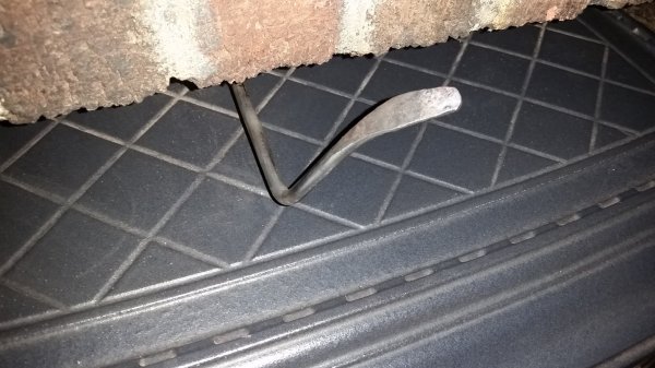

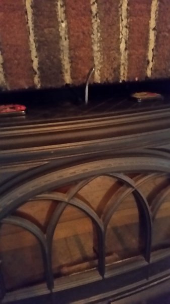

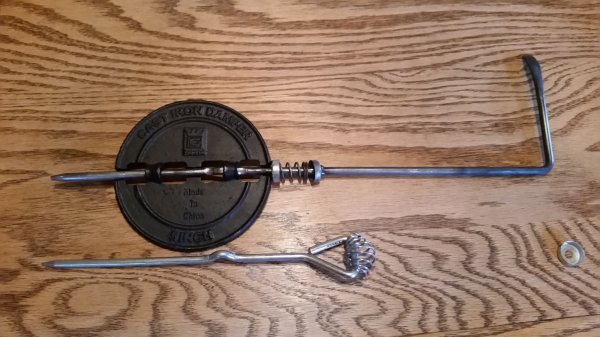

    This was a just a small project, but took lots of adjusting. I wanted to add a plate damper just above the stove but the metal rod is never long enough, and there is only a few inches of clearance to reach in above the stove.
    I took some 1/4" steel rod and forged the bend in it and installed in the flue pipe. I measured out just beyond the bricks and hammered a small flat handle. Up at 90 degrees is an open damper, turned right or left horizontal is closed. The spring is nice and tight against the flue pipe, so the handle stays put at any position. I've seen some pretty sloppy damper plates with play in them, but the rod does not wobble on this one.
    I took the secondary assembly out so I had plenty of access up through the outlet collar. I bought a 12" long drill bit to make the holes, and it was so worth it as I did not have to remove the stove out of the fireplace.
    New fabricated rod at top, the lower one came with the damper.

    Thank you. It was long time planning this out. The extended drill bit saved the day. I'm going to slow the choochin' down on the stove this season.
